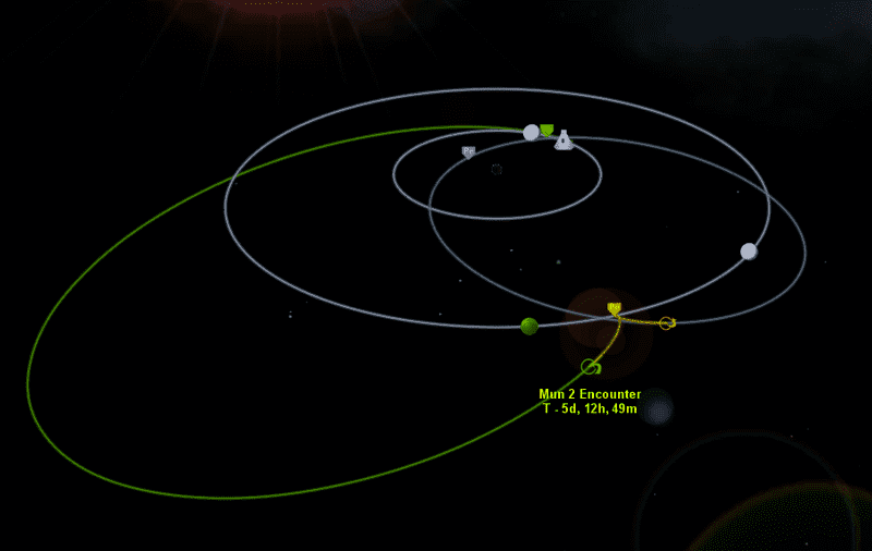

I actually have this working here already. I followed a paper by Hoots from 1984 (to some extent), and wrote a few algorithms of my own to find the solutions.
Basically what it does is first rule out orbits that won't intersect, first by simple criteria, like periapsis and apoapsis intersection, then by comparing the orbital ellipses (as per Hoots' paper). If the orbits pass those initial conditions, it runs a root-finding algorithm to converge on the point of SOI transition, and calculates the new conic patch by taking your state vectors at that point, transforming them to the coordinate system of the new body, and using those vectors to compute the parameters of the new patch.
Hoots proposed using a Newton-Raphson solver to find the solution, but that was too unreliable if the initial guess wasn't good enough. So I wrote a simpler and more robust algorithm that is probably less efficient, but much more dependable. In my case here, it's more important to be reliable than to be efficient.
All that is running on a loop, so each patch is used to find and calculate the next one, until a final patch is reached (one with no transitions), or the max limit is exceeded.
In the end, we get a list of future patches, each with its own timestamps for patch start and end, and also the true anomalies at SOI entry and exit. We use those to draw the trajectory as a 3D spline, using several options for the reference frame.
Here's a screenshot of it in action, each patch is a different colour orbit:
Apart from a few bugs here and there with the implementation, which I hope to solve soon, it's working quite well. It's actually more accurate than the actual flight simulation, and I'm thinking about using it as more than just an analysis feature in the game... Well, eventually. :)
