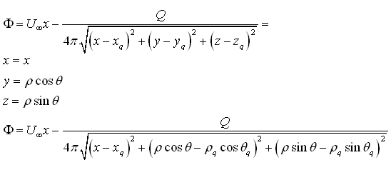

I have the following problem with respect to fluid mechanics:
A source of strength Q is in a 3D space and subjected to a parallel flow U along the x-axis. The position of the source is at (xq,yq,zq). This will lead to the following velocity potential in cartesian and cylindrical coordinates
figure 1

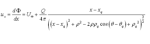

With the velocity in the x-direction determined to be
figure 2
