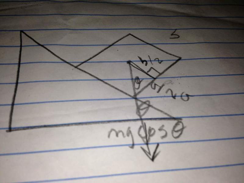

I drew a picture, I just don't see the relationship.
Here's what I was thinking:
The square is at a right angle to the ramp, so no use of theta there. I thought of drawing diagonals/parallel lines, couldn't find how to relate theta either. Could you give me a hint?

When you're at the critical angle, the force passes through the CoM and the PoR. Consider a line connecting these two points. What is the angle between this line and the wall of the box? Hint: this line is vertical, and the wall of the box is perpendicular to the incline. You know that theta is the angle between the horizontal and a line parallel to the incline. To get from the horizontal to the vertical, you just rotate by 90 degrees. To get from parallel to the incline to perpendicular to the incline, you also just rotate by 90 degrees. So, if you just rotated both lines by 90 degrees, has the angle between them changed?
No, the angle has not changed. that angle is still theta. Ok so L, where L is the length we have discussed, is simply theta degrees above the vertical. So Lcostheta = a and Lsintheta = b

No, much simpler than this. Just geometry. You have a line joining the CoM and the PoR. It's at an angle of theta from the wall of the box. So, it forms a right triangle with a section of the side of the box of length ____, and a section parallel to the bottom of the box of length ____. Based on this right triangle, you have a relation between theta, a, and b.
Here's my diagram: Is this what you're saying?
That is, in fact, exactly what I am saying. So what is theta, in terms of a and b (using trigonometry)?
tanθ = b/a
Ahh, now I can solve the problem.
