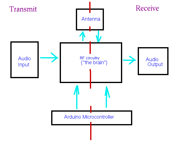

Okay, basically what I'd like to be able to do is have some sort of "universal" RF (FM) audio circuit. Actually, two: One for transmitting, and a separate one for receiving. (I'd prefer to keep it simple, and therefore not a transceiver circuit. This is for one-way communication.)
My ideal setup would be like the diagram below; I don't know if I'm using the proper terms for the different parts, of if this particular type of circuit is even physically possible.
  • The red line separates the transmitter diagram from the receiver diagram - rather than draw two completely separate ones, I just put them both there, and the red line is like the "transmitting distance" that the signal goes (not drawn to scale).
  • The Arduino microcontroller sends a "frequency selection pulse" to the RF circuit (sort of doing what an oscillator would, was my thinking).
  • Audio is the analog waveform - I think I can figure out amplification for the audio by myself, but this RF circuit thing has gotten me stuck.
  • Arrows indicate direction of data flow.
Not sure what you are asking.
Are you trying to send data on an FM transmitter?
Apart from the legalities, why are you trying to do this?
Are you trying to control something or send data for some other reason?
Just switching a transmitter with a micro is quite easy, but it depends on what else you are trying to do.

I used the term "data", but in this case, I'm just trying audio.
I am aware of legalities, I'm not planning large scale - just tinkering for the sake of experience.
Eventually, though, I would like to have a short-range system like this - as in, a transmitter connected to my computer, and a few receivers, located at select spots in the house, so that I could be notified (via an audio cue) of various things (such as RSS updates, new email, et cetera).
When I do get that far, though, I would definitely make sure that I couldn't pick up the signal from outside the house (maybe giving a foot or two leeway near windows). Also, I know some law enforcement officials, so I'd talk to them before I put too much effort into this project.

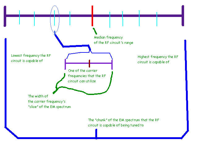

With this type of thing, is there a strict limit on the variety of frequencies that could be used with the same circuitry, or is it quite broad? (Would it be limited to +/- 50 MHz, or would +/- 2 GHz be obtainable with the same device, but different pulse rates?)
An FM transmitter normally operates on just one frequency and this is pulled slightly to transmit information.
A commercial broadcast transmitter might shift in frequency by +/- 50 Khz at 95 MHz which is only 0.1 % of the carrier frequency.
FM transmitters used in cars for mobile coummunications may only use +/- 5 KHz deviation, or less.
Transmitters have to be designed for the frequency they are used on. So, you can't use a 90 MHz transmitter on 500 MHz.
If you just wanted to signal that something had happened, you could just make a noise at the computer.
There are plenty of low powered FM transmitter circuits and kits available on the Internet. These are typically used on the 90 to 108 MHz FM band where the commercial transmitters transmit. They usually have a microphone attached, but this could be modified to accept data.
This band has the advantage that receivers are readily available.
Such low powered transmitters would not be detectable beyond house boundaries unless you attached a larger antenna than is intended.
Not sure what you mean by this:
If you mean could you use deviations like this on simple equipment, the answer is NO.

Below, I use the term "selectable frequency" where I think it might refer to "carrier frequency", also I'm not referring to "deviation", if that is the "drift" from the carrier frequency to distinguish/encode data/audio being sent. Where you said "FM band", I mention the "frequency range"; perhaps, in my case, this should be called "frequency band for cf8's hard-to-describe circuit idea"?
For example:
For the +/- 50 MHz, having the circuit's selectable "center" frequency be no lower 100 MHz, and no higher than 200 MHz; in this case, the "middle" of the selectable frequencies would be 150 MHz.
Putting it in context with the FM broadcasting range, no lower than 90 MHz, no higher than 110 MHz, so 100 MHz as the "middle" of the selectable frequencies, and +/- 10 MHz frequency "range". (Yes, I know these numbers are not quite accurate, but rounding like that made it easier to explain.)
So, for the +/- 2 GHz, an example for the range of selectable frequencies might be 27 MHz to 4.027 GHz; therefore 2.027 GHz "middle" of the range.
Still not getting you.
Do you mean something like a scanner where you might select one of 10000 possible frequencies, but each one only occupies 10 KHz?
Spread spectrum is something else.

I don't really need for any particular carrier frequency to have a specific width, if that's what you're asking.
Maybe this will clarify a bit:
Now to explain an example. My RF circuit's frequency range (the possible frequencies it can be tuned to) has an upper limit and a lower limit; the median of these would be, for example, 100 MHz. In this example, if the upper limit were 110 MHz and the lower limit were 90 MHz, then I was saying that my frequency range would be 100 MHz, +/- 10 MHz. (100 + 10 = 110 = upper limit; 100 - 10 = 90 = lower limit)
The pulse from the Arduino would determine the carrier frequency; for example 102.35 MHz. This is analogous to using a dial on a radio in a car to select what carrier frequency you want to hear. (Which is the same one transmitted by the radio broadcasting station you want to listen to.)
