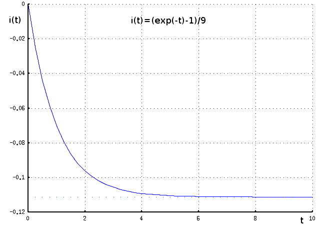

That looks over-complicated.
However, you have seen that your original question has been answered.
In the following I will use lower case for the time varying current i(t) and upper case I to denote fixed values - I find that easier to read. I'll repeat the first part of what you did for clarification. As always, check my working[1]: this is supposed to be illustrative, not correct.
In standard form, the DE is:
[tex] L\frac{d}{dt}i + Ri = V_f \left ( 1- e^{-t/RC} \right )[/tex]
So you need an integrating factor of [itex] e^{Rt/L}[/itex]:
[tex] i(t)=\frac{V_f}{L}e^{-Rt/L}\int e^{Rt/L}(1-e^{-t/RC})dt[/tex]
... expand the integrand:
[tex] i(t)=\frac{V_f}{L}e^{-Rt/L}\left ( i_1 - i_2\right )[/tex]
... where:
[tex]\begin{align}
i_1 & =\int e^{Rt/L}dt\\
i_2 & =\int \exp{\left [(\frac{R}{L}-\frac{1}{RC})t \right ]}dt
\end{align}[/tex]
... using [itex]a\int e^{at}dt = e^{at}[/itex], divide through by L, gives:
[tex] i= V_f\left [
\frac{1}{R}\exp{\left [ ( \frac{R}{L} )t \right ] }
- \frac{RC}{R^2C-L}\exp{\left [(\frac{R}{L}-\frac{1}{RC})t \right ]}
\right ] e^{-Rt/L} +c [/tex]
... where c is the constant of integration, determined from initial condition (i.e. [itex]i(0)=I_0[/itex])
[tex]I_0 = \frac{V_f}{R}- \frac{RCV_f}{R^2C-L} + c[/tex]
If I expand the brackets and then collect like terms I get:
[tex]
i= V_f\left [
\frac{1}{R}
- \frac{RC}{R^2C-L}\exp{\left [-(\frac{1}{RC})t \right ]}
\right ] +c
[/tex]
Which should give an idea if how it behaves.
When [itex]t \gg RC[/itex] the exponential term vanishes, leaving:
[tex] i(t \gg RC) \rightarrow \frac{V_f}{R} + c =I_f [/tex]
Putting I0=0 and (given figures) RC=1, V=100, L=1000, R=100; the equation becomes:
[tex]i(t)= \frac{1}{9}\left ( e^{-t} - 1 \right )
[/tex]
The current starts at 0 and decays exponentially to -(1/9) units with a mean-time of 1s.
[1] I am not going to guarantee any of these calculations are 100% correct or correctly performed. Finding my mistakes is left as an exercise for the student xD
