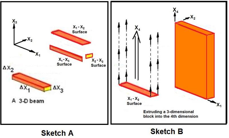

Well, maybe I'll give the picture approach a try here. I'm afraid it will get lengthy and annoy some folks with the amount of space taken up by sketches. Maybe we can break it up into a sequence of posts.
Here's part 1. For this approach it is critical that you initially try to wrap your head around the concept of a 4-dimensional universe. In some sense all observers move at the speed of light straight into the 4th dimension. So, I start with this picture of a piece of the 4-dimensional world showing a rendition by Paul Davies:
To further think through the 4 dimension concept, consider sketch A below. We start with a 3-dimensional beam, then see if we can focus on just one surface of the beam at a time. You can build a picture of a 3-D beam by starting with anyone of the surfaces and then extrude it into the direction perpendicular to the starting surface. In sketch B we similarly build a 4-dimensional beam by starting with a 3-D beam and then extruding it into the 4th dimension. The only trouble is that we can't show all 4 dimensions in a sketch, so we just show X1 and X2 and indicate an extrusion along the 4th dimension, X4.
(...continued in part 2)

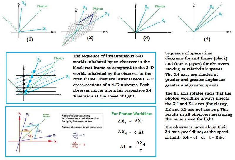

Part 2. I will try taking a giant step here. We can insert more background and detail if needed. We have constructed a 4-dimensional beam. Now we describe a situation with two observers (two physicists studying special relativity effects) one guy at rest in the black inertial frame of reference below and another guy moving at relativistic speed along black's X1 axis. Blue is actually at rest in the blue inertial frame. The blue guy carries along the 3-dimensional beam as he moves along the black X1. But, actually, since all objects are 4-dimensional (including the bodies of the observers), there is actually no motion at all in the 4-dimensional world--only the consciousnesses move at the speed of light along the 4th dimension world lines.
Here is the whole point of insisting you wrap your head around the concept of a 4-dimensional universe: When the black guy gets the impression that the 3-D beam is moving along his X1 axis at relativistic speed, it's just because the beam is really a 4-dimensional object and that object is slanted relative to black's vertical X4 axis.
Now, the big clincher for understanding special relativity is catching on to a very strange and mysterious thing that nature does for an observer whose X4 axis is slanted, i.e., the blue X4 axis in our example: Nature somehow rotates the blue X1 axis such that a 45-degree line always bisects the angle between the blue X4 and X1 axis--no matter what the angle of blue X4 is. And of course that same 45-degree line bisects the black X4 - X1 angle as well. And guess what--that 45-degree line is the world line of a photon. The 4-dimensional photon particle is always oriented as a straight line bisecting X4 - X1 angles for all inertial frames of reference. More on that later.
(end Part 2)

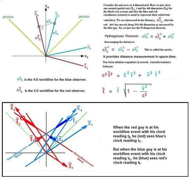

Part 3. Just to emphsize the strange effect associated with relativistic motion of an observer, we show sketches (1) thru (4), where observers moves at ever increasing relativistic speeds with respect to the black rest frame. Notice that the instantaneous 3-D cross-section of the 4-D universe experienced by the blue guy corresponds to the X1 axis (X2 and X3 not shown for simplicity), and that X1 axis is always rotated such that the 45-degree worldline of the photon always bisects the angle between X4 and X1. This is why the speed of light always has a value of c for any observer, no matter what his speed.
Again, I want to emphsize the importance of understanding the example of the upper inset box showing that the black guy and the blue guy literally live in two different 3-dimensional worlds, each one just a different cross-section of a 4-dimensional universe.
Part 4. Finally, the payoff. If you have understood what we've done so far, then if you remember the Pythagorean theorem from high school algebra you are now in a position to derive the time dilation equation (Lorentz transformation--although not in it's most general form). This time we have the black guy in his rest frame observing the blue guy moving at relativistic speed along black's X1 axis (same as before). But now we add a red guy moving at the same speed along black's negative X1 axis (blue and red move in opposite directions).
Notice in the bottom sketch that we have both blue and red carrying a beam along with them. You can compare the lengths of the beams as viewed by each. You can see right away why we have the length contraction phenomena of special relativity. If you look along blue's X1 axis at his time 2 you will see that the blue beam (in his 3-D cross-section view) is longer than the red beam (look along blue line labeled "Simultaneous Blue"). So, blue says, "Hey, the red guy's beam has contracted--it's shorter than mine." But, the red guy's instantaneous 3-D cross-section of the 4-D universe extends along a different direction in the 4-D universe (red line labeled "Simultaneous Red"). So, red says, "Hey, the blue guy's beam has contracted--it's shorter than mine."
We could derive the Lorentz transformation for that, but I'll just let the picture tell the story.

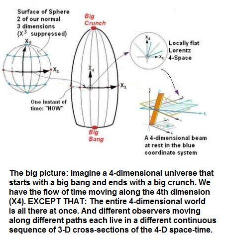

Part 5. We'll conclude the series with an example of the well known lightning flashes at the train station. A train is moving through the station at relativistic speed with one observer standing on the platform (in the black rest frame below) and another observer seated in the middle of the train. The observer on the platform sees simultaneous flashes of lightning, one at the front and one at the rear. What does the passenger on the train see? The green lines drawn at 45-degree angles are the world lines of the photons. We idealize the flashes of lightning as single individual photons of light.
