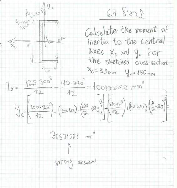

Statics, moment of inertia simple square-shape...need help (no calculus)
Calculate the moment of inertia to the central axes Xc and Yc for the sketched cross-section.
Xc = 33.9 mm
Yc = 150 mm
http://img822.imageshack.us/img822/1303/97823499.jpg
Uploaded with ImageShack.us
Moment of inertia geometrical shapes. No calculus.
Answers are
Ix = 1.008 x 10^8 mm^4
Iy = 1.085 x 10^7 mm4
attached. I accidentally wrote Yc in the last equation instead of Iy...

Your horizontal distance of the smaller rectangle has been taken as if it was horizontally centered, but it's not...
I've been trying to think what you mean but I'm not sure. Are my distances incorrect?
You have your distances as:
(125/2-33.9) for the larger rectangle, but (110/2-33.9) for the smaller rectangle.
The latter is incorrect.
Perhaps if you draw it on paper (accurately enough), you can measure the distances and you'll see what I mean.
Note that it's always useful to make drawings like that if only to verify no mistakes were made.
Got it! So the distance should be 125-110/2-33.9 = 36.1.
Yep, right answer now :D Merci me amora!
