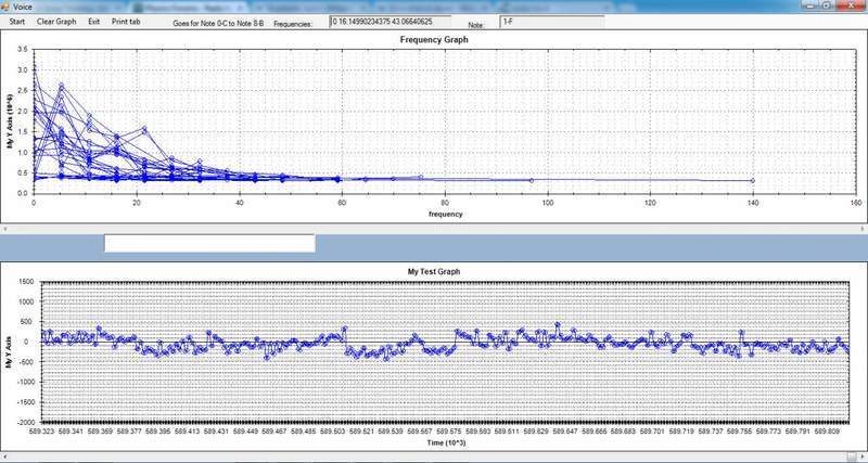

The plots in that video look a complete mess at low frequencies. Even at high frequencies like 440 Hz you are picking up stray noise from a car outside, etc (you can see it on the FFT and hear it on the video).
I would start by plotting several cycles of the wave in the time domain, not just the few points you have on the screen. At 49 Hz and 44100 samples/sec, there are 900 sample points in one cycle, so you want to plot a graph of 5000 or 10000 samples to see what the data looks like. (Yes I know the resolution of your computer monitor is less than 5000 pixels wide, but don't worry about that, just plot the graph.)
Putting your microphone as close as possible to one of the loudspeakers might help.
If you don't have something that actually looks like a sine wave with a reasonably large amplitude, the FFT won't separate the signal and the noise by magic.

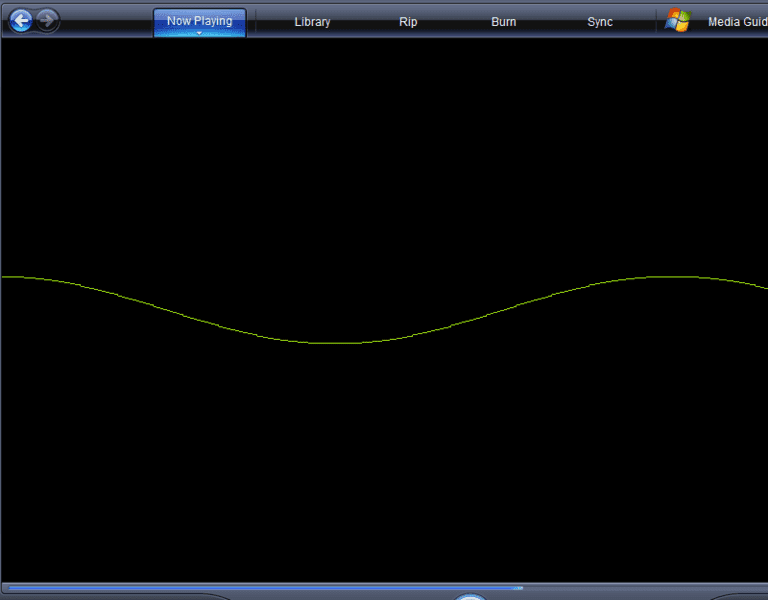

I downloaded a 49 Hz file from your tone generator site and played it in Windows Media Player. The Media Player display looks like this - a nice clean sine wave.
It might be a bug in your code, or a poor quality microphone and sound card on your PC, or you are working in a noisy environment.

ok so no it is not a noisy environment. at the end of the video one of my roommates came in, but that is it. before that is was not a noisy environment.
yeah there is a lot of noisy in my input .. I do not know why...
but I have to do a filter before I output the fft to the graph ...
I say any frequencies with a Magnitude less then 3000000 .. do not output...
is that very bad?

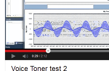

Looking at a still from your video
It looks like you have two sine waves, with different amplitudes and 90 degrees out of phase with each other, and you are taking data points alternately from each one.
I think you need to fix that problem first.
Possibly you are reading stereo audio data but thinking it is mono, so you are taking alternate signals from the left and right channels. That might also explain your earlier problem with your FFT frequencies being wrong by a factor of 2. But that doesn't explain how where the stereo data is coming from. Maybe the Mac audio system is somehow merging the data from the tone generator website on one channel, and the data from microphone on the other channel, and the phase difference is because distance between your loudspeaker and the mike just happens to be 1/4 of a wavelength at that frequency. But I'm not a Mac user, so I'm just guessing here.

sorry but I do not understand... why does it look like I am " reading stereo audio data but thinking it is mono"?
The code you posted (in a different thread) read an array of data as 8-bit bytes, and then converted each pair of bytes to a 16-bit value.
For stereo data, the buffer will contain
Sample 1 left channel
Sample 1 right channel
Sample 2 left channel
Sample 2 right channel
Sample 3 left channel
Sample 3 right channel
etc.

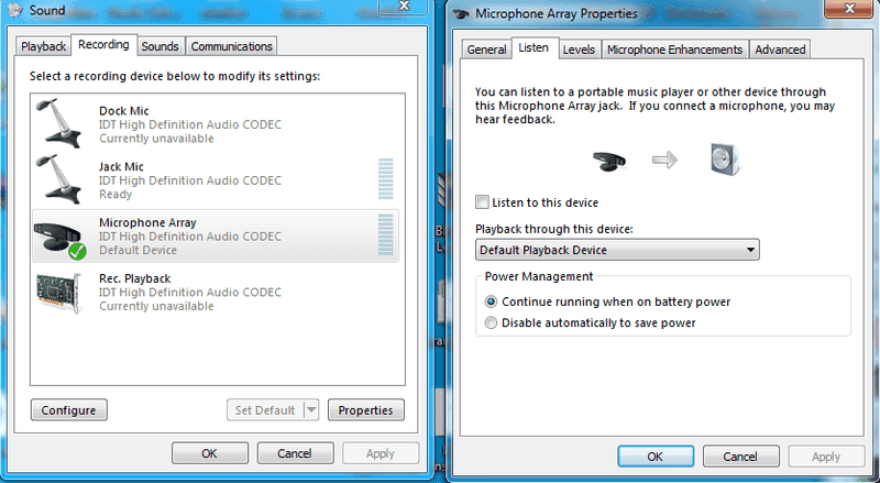

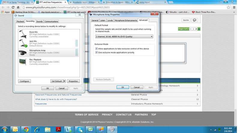

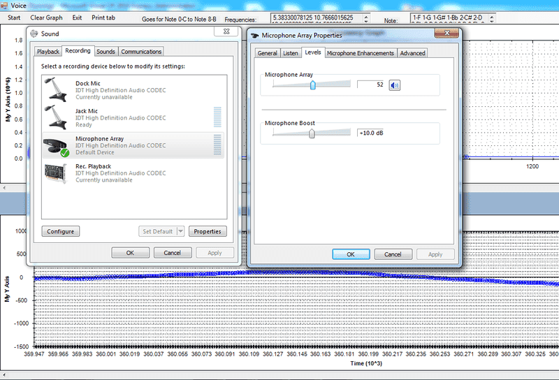

oh i just check my setting and it is
2 channel, 16bit, 48000HZ(DVD Quality)

Find out how to set up the Mac audio so it generates an audio data stream with one channel (not two), coming from your microphone.
Then find out how to make C# read that audio data stream, and not a different one.
I'm not a Mac user, so I don't know how to do those things. The only thing I know about Mac audio (from other forums on computer music) is that there are lots of options you can change!

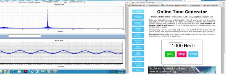

Ok so
I am using a built in computer microphone. so there are no connect to be make.
And I am using a Dell Computer...
now my problem comes in with noise in my input ...
so there no noise in my room but I get this :
and this is which
Math.Abs(F.Magnitude) > 300000

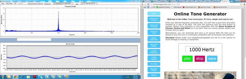

You need to go right back to square one and check out each individual link in the chain.
If you record 'silence' and then a burst of high level 1kHz, what does the straight play back sound like? Noisy? Also, what does high level 1kHz look like when plotted on those two graphs ("my test graph")?
The make of the computer should not be important for this. If it has an internal microphone, does is have an identifiable sound card or does it not have 'slots'?
  • #34
ok here is how it looks:
  • #35
You missed out the y-axis on the latest pics. but it looks ok. However, I wonder if you have just set the gain of the mic to auto and you are just seeing a scaled up version of the most recent pictures in the previous pictures.
You should find that somewhere in the options.
