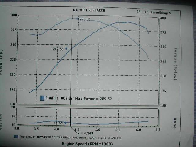

I totally agree, that rear wheel torque is equal to the engine torque though the ratios at any vehicle speed. If folks talked in terms of that, the world would be a much better place, but instead, folks talk in terms of engine torque as a comparitive value. Is not, an as you seem to agree, it depends on engine rpm and then gear ratios to be of any value.
area under the engine torque curve will be meaningless without gear reduction ratios mixed with rpm. area under the rear wheel torque curve, through the gear box is correct, but who has this data? using area under the HP curve or Watt-seconds, would be a much easier way to optimize vehicles acceleration over a operational speed range, right?
I have a dyno run (https://www.physicsforums.com/showpost.php?p=2128716&postcount=1) that shows a graphical representation of two engines, one with more torque than the the other, even though their HP's are equivilant. clearly, the lower torque engine has more accelerative potential. this is not common, but possible. I have actual dynos of cars I've raced that have a similar message, that sometimes, the lower torque engine can have a broader HP curve and produce more rear wheel torque at any vehicle speed. I just want to be able to explain why, correctly! thanks!
Mk
xxChrisxx said:
Regarding your original question, yes it is more clear now. The answers I gave are still the same for everything else. But the fact that its in a higher RPM range and is well geared, both should accelerate the same as long as they ar eboth in their peak power band. The engine with more torque has a wider band, so will pull better from lower rpm. The revver will do all of its useful work at higher rpm.
You are still confused over torque and horsepower. You said I could be way off by looking at only that, this is not the case. As hp is calcualted directly from torque, to it really makes no difference if we use power or torque, the sums will be different but we'd ge tthe same answer.
Power = Torque * angular velocity.
I prefer using torque purely as that is the acutal real world driving mechinsm of the engine. The point you make that torque figures alone are pretty much useless is true, without knowing the engine speed they arent helpful. Using the torque value a trear wheel is a more useful figure from a design perspective, as the size of the wheel has no bearing on the torque, but it will affect RWHP reading and therefore acceleration. So say you calcualte your acceleration times with a 14 inch wheel on a dyno, if you are using RWHP you'd need to re run it as the figure would no longer be valid for the new wheel. By using the engine torque you eleiminate this issue. Although is technically not strictly correct you can say that RWHP determines the torque at the rear wheel, but again this makes it sound like power dictates torque when really its torque dictating power.
You are correct in that to use the engine torque, you'd need the gear ratio and rpm of the engine. This for practical purposes makes the RWHP reading from the dyno more convenient to use, however this also leads people into the false sense that the driving force is power and not torque.
By using Engine T * Gearing * %Losses = Wheel torque
and Using the RWHP
Its making more yes you are correct, its making more power so the forces a the rear wheel will be higher. This is only becuase the torque is being applied more rapidly.
Im going to have to dig out my books on integrating curves. I'll have a read up tonight.
So summerise: both ways will give you the same answer. Using the power and vehichle speed is more convenient to calcualte quickly. but using the engine torque is a more powerful tool for analysing engine performance.

I get it, its getting to be less and less of a chicken and egg thing. force is what causes the acceleration. got it. Hp is a measure of of the rate the force does the work. HP is a vision into what the potential force is though right? or is it just a distilled version of what you need to really look at, an indicator when you don't have the time or the information to see the actual torque created at the rear tires.
Lets say you have a dyno, (inertia). you don't have sparksignal, you only have the car, and the gas pedal. what is the output? you get rear wheel torque, and Power, vs MPH as you floor it and hit the rev limiter, but you never know what the engine profile is of torque, correct? It could be 5000 or 10,000rpm redline.
I guess that is my point. for years I was muliplying gear ratios with the torque curves for every gear doing manual integration. Years later, i just started optimizing HP and accomplished the same thing.
Thanks for the comments. you brought me back to reality. awesome!

If you only had rolling road data without rpm signal, you'd be forced to use the power method. This is perfectly valid.
Now we've got that sorted we can look at the practical side of this. Let's talk about a track with a slow hairpin onto a midlength straight. Both cars have 4 gears, one prodeuces 50 Nm more torque than the other. You could gear the cars differently to give the same low down acceleration from the corner. The car with the lower torque would need to be geared shorter to allow it to be running in the higher rpm range.
As you have a shorter gear ratio in first and the same ratio of ratios (if you know what i mean) so that the acceleration performance ws the same the higher torque car would have less top speed.
However! If you geared the cars for the same speed in each gear, the lower torque car would likely fall off its peak power band, and would accelerate slower away from the corner, but begin to catch the higher torque car down the straight.
This is not a problem if you had a lower torque engine with a 6 speed box, as you could gear for lower accelration and still maintain top speed.
you are making the classic mistake that lots of people have made for race engines. They tune their horsepower and gears so it looks perfectly on paper (fom the dyno), but this won't necessarily transfer well to the tack.

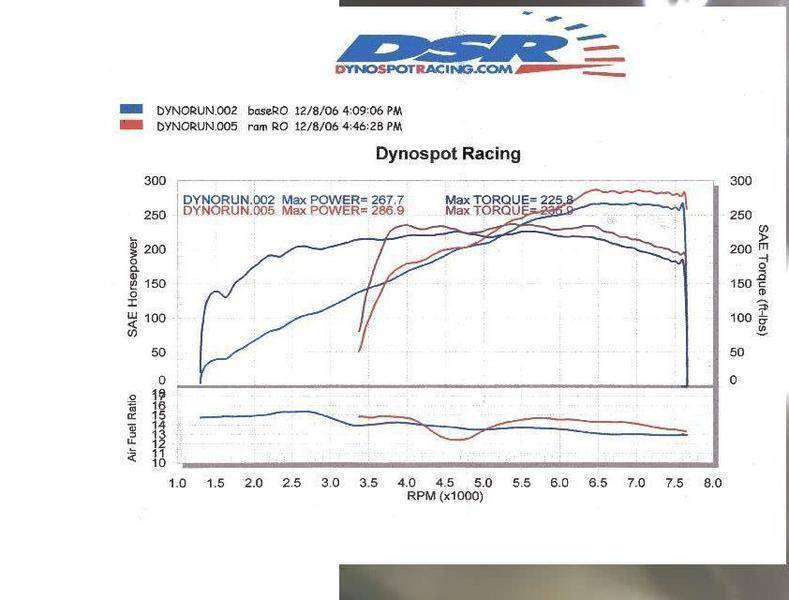

Thanks for the dyno validation, now the good stuff
I think you might be confused when you start looking at same ratios to achieve same vehicle speed in each gear. If the HP curves were the same, the acceleration performance would be the same at ANY speed on any track at ANY time. (even though one engine had 60NM less torque than the other) Of course, that lower torque engine has proportioally deeper gearing per gear and proportionally higher rpm ranges per gear. This is the classic example that there is NO difference, not in top speed, not in accelerative force anywhere.
Do we agree there?
Now, your point below that is valid that most high torque lower rpm engines have a boader HP curve, so the peaky HP curve, high rpm, lower torque engine usually has less grunt out of corners when the rpm is less than even the gear to gear rpm drop percentage. (e.g. Most are 27% rpm drops per gear, but you can be at near 55% of max rpm on some corners)
now, the closer ratio gear boxes can bridge this gap, almost entirely. in fact, they can even be an advange with being able to use more available peak HP.
As far as race cars on the track, I have 10 years of racing experience that points to not making the mistakes of some of my competitors. what i have done is maximized my gearing and HP design to fit more tracks without changes. (i.e. broader hp curve). As long as you know the rpm range, and the time spent at those rpm ranges, you can determine the best gearing to optimze available HP. (or rear wheel torque throguh the gears if you want to go through the additional math). by optimizing time spent at or near max HP, you get the greatest acceleration on the track. There are few trade offs , such as do you want to have to shift in an area of the track that might upset the car or take time for a shift, calling for an immediate downshift too soon afterward. those are considerations that can be tuned with small gearing changes. (ie tire size, rear end changes that shift the entire gear ratio set up or down)

As a note , you guys have got me looking at the power scene a little differnet. It is a highlevel indicator of what torque you have available at the rear tires. (as multiplied though the gear box). It doesn't cause the motion, Force does. Its a snap shot of what you have. However, with cars we have only engines with HP ratings. (Kw ratings like with elecric motors) with that and torque values, we get a picture of the kind of force we can apply to the ground at any given vehicle speed. the engine torque is not a good indicator unless it has the rpm attached to it, and then we can determine exactly what torque /force will be able to be achieved at any vehicle speed. without it, HP can allow us to work backward and find that engine torque at the rpm and vehicle speed to determine Force! Hows that guys?
Now, in maximizing force at the rear wheels at any speed, how do you use the time factor to know if you are maximizing force on the track? Ft-lb-seconds? If that is the better, more clear terminology, Ill use that instead of watt-seconds or HP-seconds or something in that relm.
