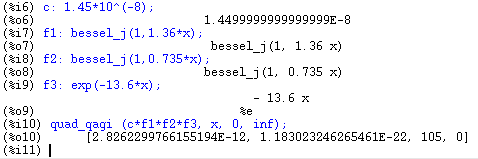

Hi everyone, I need some help solving a bessel function of the 1st order. The equation is used to calculate the mutual inductance between two inductors. The equation is:
M=(1.45*10^-8)*integral [J1(1.36x)J1(0.735x)exp(-13.6x)]dx
the integral is from zero to infinity.
Can someone help? please?
