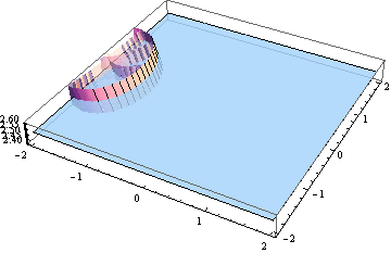

Here you go. It has been a long time since I did this, so I am not sure that I remember it all. But I am sure it is just like riding a relativistic bike :smile:
  • RelativisticRolling.nb
If you track the mark on the wheel from point A where it is in contact with the track , through one full revolution to point B where it is again in contact, wouldn't it be inevitable that the distance between marks on the track would be equal to the distance traveled by the axle independant of any intermediate motion or contraction.
That both frames would agree on these points , in the bike frame the track distance between A and B being contracted, the distance would be greater according to the track's spatial measurement.
SO the difference would be the gamma factor, yes?
If there were a line of track observers proximate to the wheel point as it traveled between A and B they would be colocated both with an observer at the mark on the wheel as well as bike frame observers at every point.
WOuldn't they agree that there was one complete revolution?
WOuldn't they agree that during the parts of the path generally transverse to the motion of the bike that the point would be uncontracted relative to the bike axle in its frame but contracted equivalently to the bike itself in the track frame??

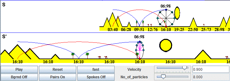

Ok, the bottom part of the wheel is actually stationary relative to road frame.
But how does this wheel look for a moving observer (the observer where this wheel is stationary)?
If all points along the wheel are moving at some tangential speed, they should all be contracted in the direction of their movement. After all, bottom point of the wheel is contracted along with the road, because it is moving at speed -v.
So, how do these tiny parts of the wheel contract? Shouldn't the wheel still have the same circular shape and same radius?
Furthermore, shouldn't points closer to the axle contract less (their speed is lower)?

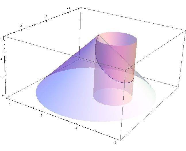

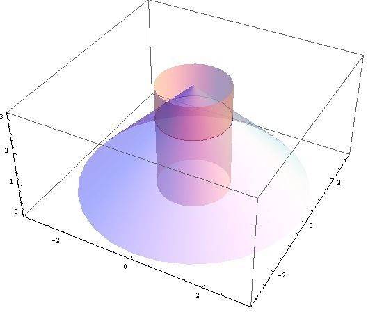

Yes, we assume that the wheel is circular in the rest frame of its center, since each point on the rim has the same speed in this frame.
From this, a simple argument shows what the shape of the wheel must be in other frames. Imagine that right next to the rolling wheel we have a non-rotating circular plate of the same radius, so that at every moment in the wheel's rest frame, each point on the rim of the wheel is right next to a point on the rim of the plate. It's a purely local fact that each point on the rim of the wheel is always right next to a point on the rim of the plate, so this must be true in other frames too--therefore, the shape of the wheel in other frames must be the same as the shape of the non-rotating plate in other frames, which is just an ellipse with the axis parallel to the direction of motion shrunk due to length contraction, and the axis orthogonal to the direction of motion having the same length as in the plate's rest frame.

My version of the wheel has six spokes. A spoke, rotating in space becomes a three-dimensional helix in space-time. The general form for this helix is a two-variable parametric equation in r and t: x,y,t=(r cos(omega t + theta), r sin(omega t + theta), t)
The surface is formed by allowing r to go from -1 to 1, and letting t go from some arbitrary time in the past to the future.
The advantage of expressing it as a parametric equation is that the Lorentz Transformations can be directly applied to the helix to form the new spacetime surface, from the perspective of someone to whom the wheel appears to be rolling by.
After you have done this, the parametric equations need to be "re-parameterized" in terms of the new t' variable. I actually didn't complete this task, though I might revisit it later. I found a way to shortcut the process for animation.
Instead of showing the entire helix, which extends from about t'=-10 to t=+10, I show a very small region from t'=c-0.1 to t'=c+0.1, and since Mathematica was able to plot this constricted region, by having c increase, I was able to give the appearance of motion in three-dimensional space.
The actual space-time plot is static. All that is changing is the value of t', so you can picture a flat surface sliding up a leaning helix, and the animation just shows that flat (constant t') surface.

The attached image is a screen shot of a java simulation of a relativistic wheel I did a long time ago, based on equation derived by Dalespam. The top half of the diagram (frame S) is in the rest frame of the wheel and the background is length contracted and lower half (frame S') is in the rest frame of the background with a length contracted wheel. The simulation traces the paths of two opposite particles on the rim of the wheel. The traces paths nicely demonstrate the long strides taken by the length contracted wheel. There are clocks in the background and in the wheel frame that demonstrate simultaneity too. If anyone actually wants the simulation so they can run it live, they will have to PM me as it too big (2000 kb) to upload here.

Hi JDoolin. I like your animation. It is a pity not many people have viewed it because it very nicely shows the "bizarre" but accurate curving of the wheel spokes in realtime. Nice work!
Thanks, yuiop. I also remembered where I've seen another gif animation of the wheel,here: http://casa.colorado.edu/~ajsh/sr/contraction.html, on Anderw Hamilton's website.
I am still working on an a related question. This animation shows what the wheel would look like some long distance away, passing by, perpendicular to the line-of-sight. It would also be interesting to imagine what the wheel would look like from the perspective of an observer on the rim, or on the axle.
In particular, I'm trying to either confirm or refute the results of Misner Thorne Wheeler's Gravitation Section 2.8 "The Centrifuge and the Photon."
Unfortunately, my Christmas break-time is just about over, so now I'll have to work in time to think about this between grading and teaching, instead of just between eating, visiting, and video games. ;)
Attachments: To find the view from the perspective of a point on the rim, one must consider the past-light-cone drawn from the event of observation. This gives the locus of events observed at that moment. To find the event locations you must do the Lorentz Transformation on that locus of events. Then, there is more involved if you want to calculate the relative velocity (which seems like it ought to be zero, but I think that our common sense may actually fail us here.)
