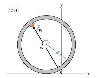

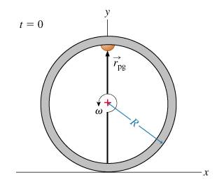

ou are to find the coordinates of a pebble stuck in the tread of a rolling tire that is rotating counterclockwise (i.e., in the positive sense) with angular velocity w. The tire rolls without slipping on the ground (which is at y=0). The outer radius of the tire is R. At time t=0, the pebble is at the top of the tire, as shown.
(a)Find the velocity of the axle of the tire relative to a fixed point on the ground, [tex]\vec{V}[/tex]ag. Note the order of the subscripts: velocity of axle measured relative to the ground.
Express your answer in terms of R, w, and [tex]\hat{x}[/tex] and/or [tex]\hat{y}[/tex].
(b)Find the position vector of the pebble relative to the initial point of contact between the wheel and ground at a time t, [tex]\vec{r}[/tex]pg(t).
Express the position vector of the pebble in terms of R, w, t, and the unit vectors [tex]\hat{x}[/tex] and/or [tex]\hat{y}[/tex] of the xy coordinate system shown.
(c)Find [tex]\vec{V}[/tex]pg(t), the velocity vector of the pebble with respect to a fixed point on the ground, in terms of the unit vectors [tex]\hat{x}[/tex] and [tex]\hat{y}[/tex] of the xy coordinate system shown.
Express the velocity vector in terms of R, w, t, and [tex]\hat{x}[/tex] and/or [tex]\hat{y}[/tex].
(d)Now find [tex]\vec{a}[/tex]pg(t), the acceleration vector of the pebble with respect to a fixed point on the ground.
Express your answer in terms of R, w, t and [tex]\hat{x}[/tex] and/or [tex]\hat{y}[/tex] of the xy coordinate system shown.

It's analogous.
It's something like, you can superimpose purely translatory motion and purely rotational motion.
The tyre is rolling away. So, it can be considered as sum of translation at a speed vCM and rotation with an angular speed w.
Thus, velocity of any particle on the tyre w.r.t. ground, vP, can be given as: (bold letters indicate vector quantites, 'X' denotes vector cross product.)
vP = vCM + w X r
where, vCM is velocity of centre (or, axle) of the tyre w.r.t. the ground;
w is the angular velocity of the tyre;
and, r is the position vector of any point on the tyre w.r.t. the centre of the tyre at any instant.
I hope the rest can be done.
Basically, the above formula can be obtained using simple geometry for distances, and then differentiating it once. (It's no big deal.)

For position part you may proceed like this:
Initial co-ordinate of the pebble is (0, 2R). Let the wheel translate by a distance 'x' in time 't'. Also, let the wheel rotate by an angle Θ (in radians) in that time. Obviously, x = R*Θ. Now, try to locate the co-ordinate of the pebble. Note that Θ is the angle from the vertical, in the same sense as rotation of the tyre.
Basically, what is being said is, at any instant position vector of the pebble (w.r.t. ground) can be found as vector sum of position of the centre of the tyre (w.r.t. ground) and position vector of the pebble (w.r.t. the centre of the tyre).
