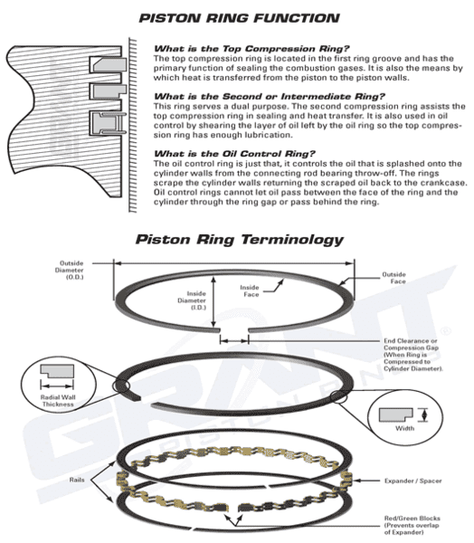

Piston rings are pressure energized. Pressure has to get behind them to push them against the wall in order for them to seal. Simply making a tight fitting piston won't provide the same sealing effectiveness.
I got to jump in here...If we are talking about internal combustion engines..
Piston rings function in sets of three rings, starting with the top compression ring, followed by the
2nd groove ring and the oil control ring. Their function is to seal off combustion gases, aid in the
heat transfer to the cylinder wall, and both lubricate and scrape down oil from the cylinder wall. The
top ring serves to seal off the majority of the combustion gases while the bottom ring provides most
of the oil control. The 2nd ring helps with both functions, playing a finishing role in the combustion
sealing as well as the downward oil scraping. Top ring transfers 45% of the combustion heat from the piston to the cylinder wall , middle ring 20% and oil scraper 5%.
Depending upon the engine and its purpose typical end gap of the piston ring can be 0.003” to .005” per inch of bore and will close up to near zero when heated to proper operating temperatures. The thermal expansion will effectively seal the ring although you can drill gas ports to the rings to assist in the sealing. The top ring is effected by combustion gags pressure and uses a unique design to assist in sealing against the cylinder wall..the other two rings do not use this technique. You need to properly hone the cylinder bore sleeve to provide enough “ valleys” in the surface profile to hold lubrication. You can over machine finish this area and ruin an engine. There are numerous surface texture parameters used to control this surface.
Contrary to common belief a piston is NOT round. It is oval shaped to better fit the bore when up to operating temperatures. The piston is elliptically turned so the diameter at the pin boss is less than the diameter across the thrust face. Under operating temperature expansion forces force the piston pin bosses away from each other causing the piston to assume a more nearly round condition. You need to run at least .002” to .004” piston to cylinder clearance with cast production pistons and as high as 0.010” with aftermarket forged pistons depending upon the thermal expansion properties..see the piston manufacturer for this.

Whoa up fellows...the Chevy Vega tried to use aluminum alloy engine block ( aluminum cylinder bore and iron coated pistons and it was a dismal failure. Why would anyone want a piston made of Iron? Aluminum is a lot lighter and has better cooling properties.
Sorry Q - Pistons do have two engineered cooling systems. The Piston rings as I have noted above in my post and the engine oil lubrication system cools the inside of the piston in a controlled and predictable manner. To say it is
“In fact, pistons have some temperature distribution throughout that results in them being hotter in some areas and cooler in others such that they don't expand perfectly”. Uh...half correct and good try...but let us look at this a little more detailed.. Pistons, as noted in my above post are nor round and do not have the same degree of material. True there are areas of the piston that have different temperatures At top dead center position during combustion, but when rotating thru the Otto cycle, the piston top quickly stabilizes in temperature. So the hottest temperatures the piston top sees is for about 30 degrees of one cycle of 4 cycles and you better not have significant deviations at the piston top or we have premature detonation...kaboom. As far as expanding perfectly, better words are that Aluminum casting with differing amounts of material and these do not expand linearly. The pin boss area is significantly heavier than other areas.
One more thing, the clearances for the piston to cylinder wall are are relatively small ( .002” to .004”) and is almost zero AFTER the engine reached operating temperature other wise the piston would rock in the bore and wear out very quickly.
“Also, seals work not simply by taking up the space between the two parts, but because there is also a contact pressure between the seal and the surface it is sliding against. That contact pressure is created in a piston ring by the pressure it is sealing, so the higher the pressure it has to seal, the higher the contact pressure between the ring and cylinder wall. It's this contact pressure that is providing the sealing, not the fact it is simply filling in the gap. If a piston ring were made of a solid ring instead of being cut at one point, it couldn't seal properly, even if it were made the same diameter as the cylinder because the pressure it was attempting to seal couldn't push the ring out against the cylinder wall.”
If this was true, which it is not, the oil scraper would not work. The only piston ring that uses combustion pressure is the top ring. the other two are isolated from any combustion pressure. To think they are pressurized by combustion pressure is not understanding the design intent.
Note the attached pic..the top ring has a notch engineered into the ring. When combustion gas passes between the top ring and piston land during combustion it forces a gap. This gas then fills the notch and forces the ring toward the cylinder wall to more effectively seal the combination.
This pressure is controlled and is stopped from blowing pass this combination if all other factors are at design specification. Any resultant blow by is stopped by the second ring tension only. During initial start and warm up of an Otto cycle engine, we need this or you would be changing engine oil every 1000 miles.

To get back to the OP, the point about seals is that they must remain in contact with the surfaces they are sealing with sufficient contact stress to operate as seals. Without the contact stress, they can't act as seals and excessive leakage results. That's why pistons can't operate as seals simply by taking up the gap.

Not really. The pressure from the combustion process doesn't aid in sealing between the piston and wall. Even if you allow only enough clearance between the piston and wall to prevent rubbing and allow some lubricant in, that amount of clearance and the resulting leakage would be huge compared to simply putting in a piston ring. You should try doing some calculations on it, they're not that hard.
you might argue that it would need precise clearances, but wouldn't you need that for seals as well?
Piston rings are cut at one point around their periphery so they can more easily deform to take the shape of the cylinder and also to allow for differential thermal expansion. If they weren't cut, they couldn't spring out against the cylinder wall and any pressure behind the seal wouldn't be able to force the seal outwards. Cutting the ring at one point allows the ring to act similar to a beam in bending. They can spring outwards. Solid rings can't spring outward so they don't seal. They have to be cut at one point to allow them to take the shape of cylinder. The only time a solid ring can be used is when they are soft enough to deform such as rubber or plastic seals used in hydraulic applications. Obviously, those types of seals can't handle the operating temperature of an engine.
that is what my doubt keeps coming back to. whatever function the seals are serving, could be performed by the piston. no?
They really can't. Piston rings are unique types of seals designed for the issues faced by IC engines. Getting rid of them really ins't an option.
