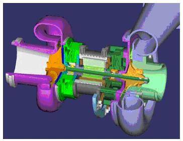

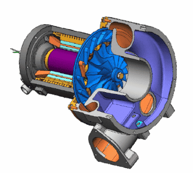

http://www.barber-nichols.com/products/specialty_products/turbo_alternators/default.asp
They can build it for you. Apparently Turbo Altenators have been around since the 80's

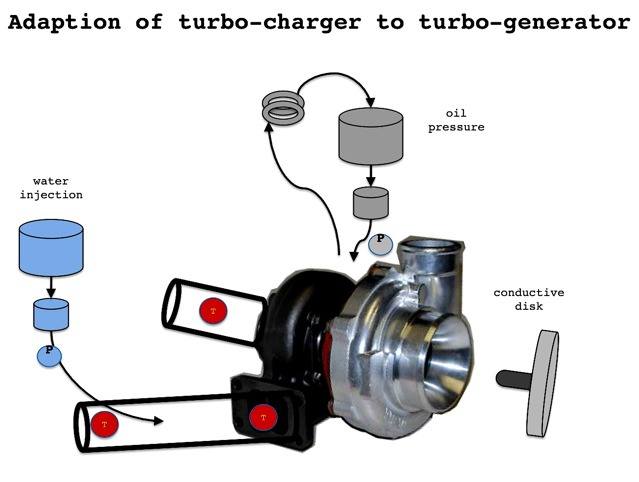

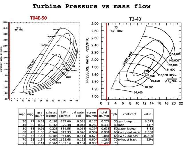

Curiously, I have been interested in this subject for several years and just started a prototyping effort:
So I bought a turbo-charger a couple of years ago and finally started blue-printing it:

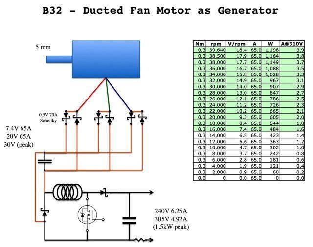

I'm building a brass-board based upon a 1.4kW rated, brushless motor normally used for ducted fan, RC models:

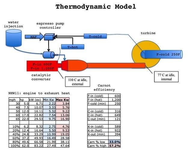

In my case, the energy recovered from the exhaust stream will be dumped into a Prius traction battery (aka., plug-in Prius style.) Sensing the higher battery SOC, the car will simply draw it down by powering the drive system. A back-of-the-envelope thermodynamic analysis suggests my goal of 20 kW may be achievable:
Most folks get hung up on "back pressure" effects which exist but given the typical turbo pressure ratios of 2-to-1 are nearly half an order of magnitude smaller than the power gain from the alternator:
Feel free to check my math but at full-throttle, 4,500 rpm, the 1.5L engine in my 2003 Prius will lose about 250 watts when the turbine is running at a 2:1 pressure ratio for an expected gain of 1.4 kW with this first prototype. If it works as expected, I'll scale the alternator to 20 kW and the back pressure effects will only slightly change. One reason for testing is to gain quantitative numbers to refine the math model.
Think of back-pressure this way, the turbo-alternator and exhaust pipe have expanded the definition of the "engine." To only pay attention on "back pressure" ignores the rest of the engine, the turbo-alternator that is producing power. It is like looking at just the compression stroke energy loss and forgetting that a power generation stroke follows. <grins>
There have been a number of technical problems to overcome in this project and 'lessons learned.' But that is why we experiment, to find out what works and what is Escher engineering.

I think you are analyzing a traditional vehicle, not a Toyota hybrid electric. My 2003 Prius only has one belt and it runs the air conditioner compressor and engine water pump. Everything else comes from the two motor generators, MG1 and MG2.
I'm really interested in seeing the result of this. Personally I don't think you will see a reduction of energy losses; I think there will be more losses with the turbo drive.
Remember my goal is to exploit the wasted heat in the exhaust stream. Think of the turbo as expanding the existing 13-to-1 power stroke to 14 or 15-to-1. We're not letting the exhaust gas reach atmospheric pressure until it gives up some of its latent energy, its momentum to the turbine. <grins>
If there were no 'back-pressure,' the exhaust gas would not even pass through the turbine. But because it is 'hot gas' and expands as it gives up its momentum, we get the last ergs. Don't treat this hot, gas as an incompressible fluid but just another expanding gas that cools a little more as it gives up its momentum.

That is one of the reasons why this prototype is important.

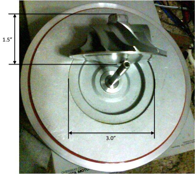

Sad to say, it is difficult to find the performance specs for turbines. I did find mass-flow, efficiency charts for the turbo charger I'd bought several years ago but my best case estimate including injecting enough water for 20 kW is not even close to the graph (see earlier post.) I've sadly oversized the turbine by nearly half an order of magnitude. But I can still get useful data and use it for system integration and test.
I have found a motorcycle turbo that is more correctly sized for the gas flow of the 64 hp of my 2003 Prius but before I spend any more money, I want to make sure the system elements work well enough to trust exchanging the turbo. There are 'devils in the details' and I don't think I've figured them all out, yet.
BTW, the 250 W, back-pressure model is for a 2:1 pressure ratio of the turbine. It turns out whatever the actual pressure ratio of the real turbine, you can multiply it minus 1 times 250 W to estimate the back-pressure overhead. But then that is why we experiment.
Bob Wilson

Bob Wilson, I think you're onto something. Rather than using existing parts and trying to cobble them together in series, you may want to make an alternator that's driven by the turbine section. So basically, you remove the compressor and replace it with the stator-assembly from an alternator. Replace the compressor-housing with the alternator rotor.
Due to the high velocities, you're going to get very high voltage AC output. A buck-regulator with induction-coil can be used to store the high-voltage and have it be returned slower as lower-voltage. Then rectify as necessary. Although the Prius uses 288v batteries, so this might actually be a match made in heaven.
