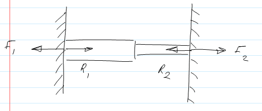

In summary, the linear actuator is pushing outwards with a force of 10N, causing all the forces in the system to balance each other. Therefore, F1 = F2 = R1 = R2 = 5N.
amrbekhit
A linear actuator is wedged between two solid walls as shown in the diagram below. The linear actuator is pushing outwards with a force of 10N. What are the magnitudes of the forces labelled in the diagrams?
I reckon that F1 = F2 = R1 = R2. However, I'm not sure if F1 = F2 = 5N or 10N. I'm guessing 10N.
Any thoughts?
--Amr
If the system is in equilibrium then all the forces are balanced.
Remember, if R1 = 10N and R2 = 10N that implies that there is 20N compressing the system and we know there is only 10N expanding it.
Jared
Hi Jared,
Thanks for your reply. Based on that, if the linear actuator produces a 10N force, F1 = F2 = R1 = R2 = 5N.
Amr
I'd agree with that conclusion.
Jared
