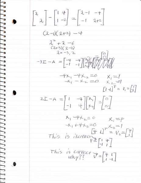

Thank you Mark44 for clarification on the symbol and thankyou sharks for now I will take a pic and submit it. And Joffan yes that is the matrix
I have attached an image of my work it should be much clearer now sorry for the scratch out on one part.

Okay, you have eigenvector [1, -1] corresponding to eigenvalue -3 and eigenvector [4, 1] corresponding to eigevalue 1. Those are correct.
You then put them together to form matrix "P" (you have it labeled [itex]\vec{V}[/itex] which is incorrect- this is a matrix, not a vector.)
[tex]\begin{bmatrix}1 & 4 \\ -1 & 1\end{bmatrix}[/tex] and declare that it this is incorrect. Why? You need to understand that there are, in fact, an infinite number of different matrices, P, so that, for this matrix A, [itex]P^{-1}AP[/itex] is diagonal. The matrix which you say is incorrect is perfectly correct. Using it as P will give you the diagonal matrix
[tex]\begin{bmatrix}-3 & 0 \\ 0 & 1\end{bmatrix}[/tex]
Using the matrix that you say is correct,
[tex]\begin{bmatrix}4 & 1 \\ 1 & -1\end{bmatrix}[/tex]
has the two columns (eigenvectors) reversed and so gives
[tex]\begin{bmatrix}1 & 0 \\ 0 & -3\end{bmatrix}[/tex]
which is also a diagonal matrix, just the eigenvalues in different places.
Ok thanks man I kinda figured it was right but the answer in the back scared me a bit
