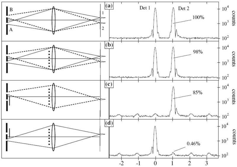

Two new papers on beautiful experiments were published this month
concerning the Wave Particle duality of the photon:Paradox in Wave-Particle Duality
S.Afshar et. Al. in Foundations of Physics.
http://www.springerlink.com/content/q110r82074w03277/fulltext.pdf
Experimental realization of Wheeler’s delayed-choice
GedankenExperiment
J-F. Roch, A. Aspect, P.Grangier in Science.
http://arxiv.org/PS_cache/quant-ph/pdf/0610/0610241.pdf

The authors of the first experiment claim to show that the photon can
have simultaneous wave and particle properties and disagree with Bohr.

The experimental result is entirely explained by Classical Optics/
EM Radiation, There's no need to use [itex]\hbar[/itex] or Heisenberg's uncertainty
principle.
"Circumventing" Heisenberg’s uncertainty principle here means that
HUP is simply not applicable to the experiment. It doesn't imply that he
claims that he found some way to change [itex]\Delta p \Delta q \geq \hbar[/itex] to [itex]\Delta p \Delta q < \hbar[/itex].
He could (should) have been clearer, certainly. Regards, Hans

DrChinese said:
3. At this point, I assume the publishing was allowed to go forward because the results themselves are reproducible. I do not doubt that there will be debate on what the results themselves say. I think the quote from Wheeler (". . . for quantum theory to say in one breath ‘through which slit’ and in another ‘through both’ is logically inconsistent...") can be construed many ways. I certainly don't see this experiment as particularly supporting it.
A good reviewer looks at the merits of the experiment itself.
I think the reviewer has been convinced that there must be an
interference pattern and that the light through the two holes is
focused on two different locations. I'm convinced as well. It's
just what you expect from classical optics. I would have liked
to see the figure on page 299 earlier. It nicely addresses the
diffraction grating ideas Vanesch and I discussed here:
https://www.physicsforums.com/showthread.php?t=59795
Now is BPC (Bohr’s principle of Complementarity) in conflict
with Classical Optics?
BPC says that a single photon can only behave either as a wave
or as a particle, but not both a the same time. Classical Optics
says that photons ALWAYS behave as waves, (until they're
finally absorbed) So yes, I think there is conflict indeed.
For me the essential point is that the wave can go anywhere,
follows all possible paths, all over the place, while the absorption
only occurs at one single place.

Bohr’s Principle of Correspondence states that if the light consist
out of sufficient numbers of photons we should get the Classical
Optics result back. No quantum mechanical interactions took place
other than the final absorption in the detectors.
Both the experiments discussed on this thread produce the results
that would be expected from Classical Optics.Regards, Hans

But I am having a little difficulty understanding their argument anyway. Do you understand it well enough to help me? Specifically, I am trying to understand the 4 diagrams a/b/c/d and how they get to the idea that the wave nature is being demonstrated. I follow that the wire is placed at minima of the expected wave pattern (going from a to b) and it is only slightly destructive. But how does that provide a convincing argument for the wave nature being observed?
One can discuss these 4 diagrams from a Classical Optics point of view:The bottom two diagram show one hole closed, one hole open. The
wave interacts with the thin wires. These will scatter the wave and
produce a diffraction pattern. (The series of little bumps in the output)
If both holes are open then there will be an interference pattern with
the wires carefully placed in the lows of the pattern. The wires don't
scatter the wave and no diffraction pattern will occur. Most of the
energy will get through unscattered.
So it's the absence of the diffraction pattern in the output which
demonstrates best that there must be interference. To see more how
diffraction patterns from an array of thin lines (or thin slits) should look,
go here:
http://www.msm.cam.ac.uk/doitpoms/tlplib/diffraction/convolution.php Regards, Hans

DrChinese said:
Thanks, that helps. So here is my next question. I am guessing that they are asserting that the path in the B picture is left to left and right to right, and they base that on the idea that the B is "built up" from the C and D pictures. So that is how they know the "which way" information. Is that correct?
Yes, although one has to be very careful in saying that picture B is "build up"
from C and D. Note that the central peak in C and D is only 85%. The missing
part has been scattered away into the diffraction pattern.
If you do a linear add of C and D then one might cancel the two diffraction
patterns because they have opposite phase add, but, there's nothing to
ADD to the 85% peak of picture C to bring it to 98% except for a little
0.46% bump in D which would be subtractive (?) rather than additive.
So the conclusion would be that the 98% in the peak is very likely to be
as good as all from the corresponding hole.
Regards, Hans
