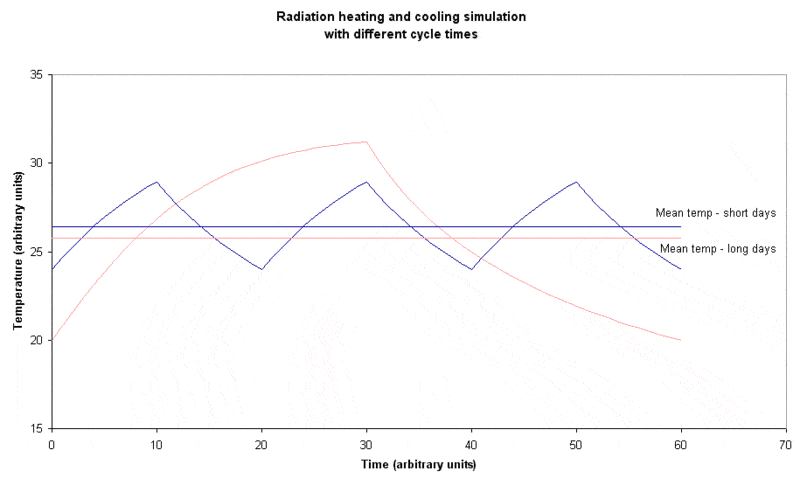

1 lunar day = 29 Earth days (approx) so the temperature range on the moon surface would be much larger than on the Earth surface. So the radiation from the "hot" parts of the moon surface would be greater than from the "hot" parts of the earth. Since radiation from the surface into "empty space" is proportional to T^4 (not a linear function of temperature), this would mean that relatively more energy was lost from the moon for the same average temperature.
The radiation received from the sun is independent of the Earth or moon temperature.
So if everything else was the same, this nonlinear effect would make the "average" surface temperature lower on the moon.
The different sizes of Earth and moon make no difference to the radiation balance. The total surface area for outward radiation, and the projected (circular disk) area for inward radiation, are both proportional to r^2. And the heating and cooling effects only penetrate to a small depth compared with the radius.
The heat from the Earth's core (which is partly generated by radioactivity) could make a difference.
BTW, I haven't tried to put any numbers to the hypotheses about the effect of day length - it would be a nice exercise in numerical solution of a differential equation, though.

This is a very crude simulation of the radiation effect I was proposing. Imagine an object with high thermal conductivity so its internal temperature is uniform. Cooling is by radiation proportional to T^4. Heat is supplied at a constant rate during the "day". The graphs show the temperature cycling once steady state has been reached for two different "day lengths". For short days, the temperature changes are almost linear with time. For longer days, the temp rise slows down as the amount of heat radiated away increases. The average amount of heat input is the same but the mean temperature is lower for long "days".
