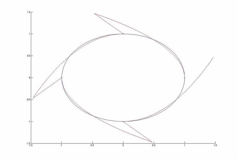

Cubic Spline Interpolation of a Circle
Hey there -
Thanks for the great tutorials - they really helped me! I'm trying to duplicate your results for cubic interpolation of a circle with 4 points and I got the same solution for the 2nd derivatives in the x and y directions. However, when I solve for the coefficients and plot the cubic polynomials I can't seem to get the same result as you - Heres the code that calculates the coefficients (in MATLAB)
mx - x''
my - y''
Sx - x coefficients
Sy - y coefficients

for i = 1:n-1
Sx(i,1) = (mx(i+1) - mx(i))/6*h;
Sx(i,2) = mx(i)/2;
Sx(i,3) = (x(i+1) - x(i))/h - h*(mx(i+1) + 2*mx(i))/6;
Sx(i,4) = x(i);
Sy(i,1) = (my(i+1) - my(i))/6*h;
Sy(i,2) = my(i)/2;
Sy(i,3) = (y(i+1) - y(i))/h - h*(my(i+1) + 2*my(i))/6;
Sy(i,4) = y(i);
end

plot(genpnx,genpny,'r')
Do you have any idea what I might be doing wrong? (Ive attached an image of what the spline looks like for 4 points)

Though I'm not a MATLAB person, your expressions for calculating the coefficients look correct. Make sure you are using 0.25 for h. Also, for plotting, t should vary from 0 to 0.25 for each segment.
Here are the coefficient values I got for the 1st segment:
ax = 32
bx = -24
cx = 0
dx = 1
ay = -32
by = 0
cy = 6
dy = 0
Actually, this isn't the best way to fit a circle with cubic polynomials. It is better to fit a quarter circle with a single parametric cubic. The tutorial has been updated - check it out.
Solution
Thanks for the coefficients - they helped me figure out what the problem was - a syntax problem - the correct expression for the coefficients are
Sx(i,1) = (mx(i+1) - mx(i))/(6*h)
while I had
Thanks a ton!
Glad to help. Fyi, the problem can be made even simpler by making h = 1, meaning s = [0 1 2 3 4]. Second deriveratives are x" = [-3 0 3 -3], y" = [0 -3 0 3 0] and plotting can be done for t varying from 0 to 1 for each segment.
