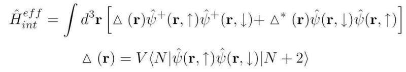

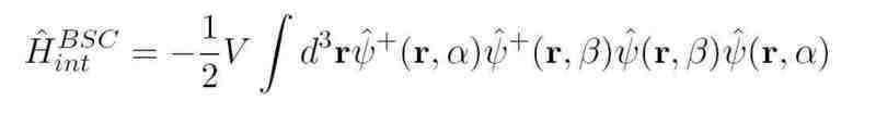

For formula references see attached images.
Bogoliubov suggested replace BCSint hamiltonian (see bcsint image) with effective mean field hamiltonian containing Hartree-Fock part (see hf image) and Heff (see Heff), where GAP function (see gap image) is C-number function.
The resulting hamiltonian is bilinear in creation and annihilation operators and can be diagonalizie by canonical transformation.
