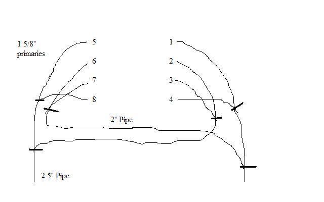

To deal with the clearance/room issue I was thinking of stealing an idea from tri-y headers. I was planning on merging the two tubes that stay and merging the two tubes that cross similar to what is done on tri-y headers. I would go from 1 5/8" primaries, merged into a 2" pipe which would then cross over under the motor or trans depending on where there is room and that 2" pipe would then merge with the 2" pipe already present from the two tubes already there. It would involve a total of 6 y-pipes.

I looked the tri-y headers over but it seemed to me that they pair the wrong cylinders together for my motor.
With my cylinder configuration, I figured I would need the first and last cylinder of one side merged and the two middle cylinders of that same side merged. The tri-y headers merge first and second, then third and fourth.
http://www.mustangsunlimited.com/ProdImages/652804-C.jpg
I was thinking of going off the tri-y design and making my own by modifying my existing headers and merging the cylinders needed, then only having one crossover tube from each side. 1 5/8" primaries merged to a 2" tube that then would merege to a final size 2.5" tube.
Sorry for the crappy MS Paint rendering.

Cross over tube is a tube connecting the collectors or exhaust pipe right after the collectors. it smooths out engine pulses.
Tri y headers are good for mid range HP and torque..if you are twisting the mill to hi end more than hanging out on the mid range ...go with 4 in 1 headers that are top end oriented...if you run a dual plane intake manifold and dual exhaust w/o cross over tube the engine thinks it has two 4 cylinder engines tied to the crank
ifin you have an open plenum intake and cross over tube you have smoother running engine as pulses are smoothed out..most road course tracks we run is 4 to 7000 rpm situation..we have Hewland Trans axle so gear changes are super easy..I don't know your gearing but it is one huge consideration..ifin you are dual purpose and running the Stang on the street too
go with 4 -1 headers and cross over tube and single plane ( open plenum ) intake..
IMO ..I been there on the cobble up a header drill..no way dude..I would buy a good set of headers from Doug Thorley, Hooker, Jere Stahl..you want min headaches at install max durability...you don't need a pin hole popping up at race event and melting a spark plug wire..it happened to us..you got 1200 degrees F at the head/header and up to 400 deg F at exit...so with stainless steel ..it will give you more HP than the 180 degree design your are thinking about..but hey..its yer racer..go for it..
