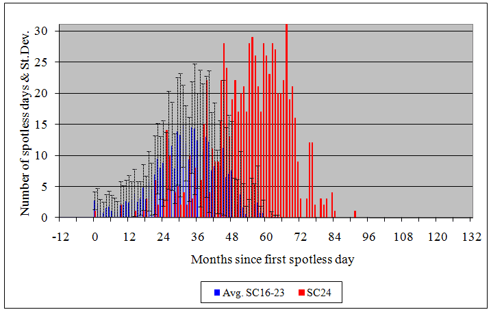

This cycle doesn't look anything like the last eight cycles. Here is a comparison of the number of spotless days per month for the current cycle versus cycles 16 to 23:

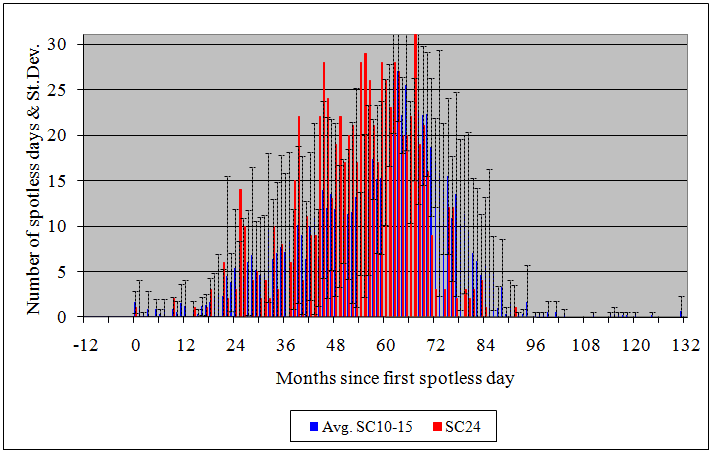

So far the current minimum looks a lot more like those during cycles 10-15:
