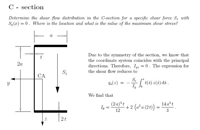

The first example I'm doing. A simple thin-walled open section.

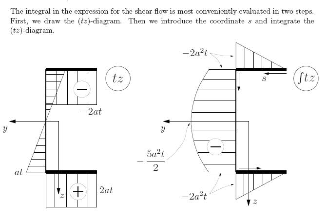

Finding Iy is simple, but then I have to sketch the tz diagram and the integral of tz. Here is the answer, but I really can't figure it out for myself
My questions are;
Why are the sketches those shapes? (Some are rectangles, some are triangles)
Why are they positive and negative and how do you work out which one is which?
Where do the numbers come from?
BIG THANKYOU to anyone who knows!
Incase anybody wanted to know, I have managed to work out the answers to my questions (Little disappointed no one attempted to help!)
The shapes correspond to the tz value. A rectangle shape means the tz value is constant, so the line is a constant, straight line. A triangle means that the tz value is linear (because it changes along the z-axis), so the slope in the line which makes the triangle displays this. Integrating the triangle (linear) value will result in a quadratic, which is the parabola shape.
The positive and negative signs simply correspond to the z co-ordinate of the shape with respect to the global axis.
The numbers come from multiplying the thickness of the bar, by it's z co-ordinate.
