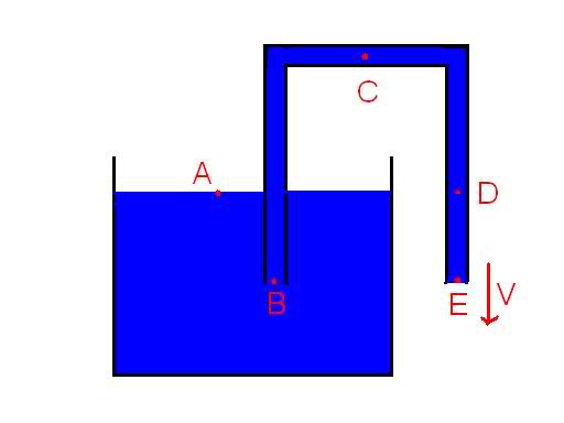

Let's say the surface of the fluid is very big as compare to the tube diameter.
Are my assumptions below correct?
VA=0
VB(inlet of the tube) = VE, i think so because the diameter of the tube is constant.
And the velocity through the tube all are constant.
or VB(inlet of the tube) = 0? but it could be right?
Which point has the lowest pressure? should be PC or PE?
Are the pressure of PB and PE the same?
Is the PD = 0?
will all the pressure be different value if the fluid in a stationary motion?
thanks all.
