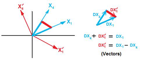

Because it is the leg of a triangle that is being computed, not the hypotenuse. Google "special relativity space-time diagram" to study how to interpret the sketch below. We have red and blue guys moving in opposite directions at the same relativistic speed relative to the black coordinates. The blue guy uses the equation to compute the length of some object in the red guy's coordinates. Then, it's the red leg of the triangle that's being computed.
Given the way the coordinates are oriented for red and blue in special relativity, you can identify a right triangle--then just use Pythagorean theorem and solve for the red length. dX1'^2 +dX4^2 = dX1^2. Or, use vector addition as shown.
