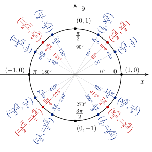

There's a more general definition of sin and cosine.
Consider the unit circle, and imagine a ray emanating from the origin making an angle of [itex]\theta[/itex] with the positive x-axis. You can see right away that this is perfectly well defined for all angles.
Now the ray intersects the unit circle at a point (x,y). We call the x-coordinate [itex]cos \ \theta[/itex], and we call the y-coordinate [itex]sin \ \theta[/itex].
You can (and should) convince yourself that this definition corresponds to the usual triangle-based definitions from trig; and that sin is now perfectly well defined for 90 degrees.
One nice feature of this way of defining the trig functions is that you don't have to memorize anything about quadrants. You just read off the x-y coordinates for any angle, regardless of quadrant.
My favorite presentation of the above facts.
