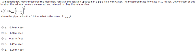

I am interested in why my method is flawed:
Alright I know how to do this problem. Essentially you solve mass flow rate = rho * double integral of u dA. HOWEVER, I decided to do this differently. I know that I can solve for the average u from the equation mass flow rate = rho * u_avg * A. I also know that the average u is just the integral of u over the integral of 1. I tried this and I get 1.528 m/s which is clearly not one of the answers. Why does my method not work?
