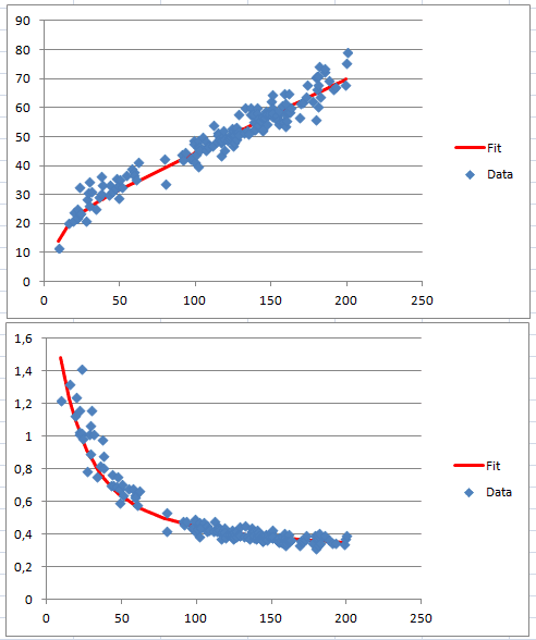

If you want an x in the denominator, it is easier to look at y*x as function of x. There, a linear fit is actually reasonable, especially if we can ignore the first datapoint (at x=9.5) as outlier.
It is easy to adjust that shape to fit better to the lower values, for example with f(x)=0.255 x + 19 - 19 e^(-0.1x). I did not optimize it yet (and I'm not used to measured values without known uncertainties), that's just by eye. But that arbitrary exponential there looks like overfitting, at least without a physical model behind it.
Here are y*x and y as a function of x, with f(x) plotted on top:

Very impressive! You must do this often to be able to "eye" a fit?! Can you explain a little more (maybe in a different way) on what you've done here? I don't quite understand "y*x as function of x".
This is a model to describe relative changes in bulk density of a material, so no physical model is really possible. The variability in the data is due to measurement error and other factors but very difficult to isolate.
Also - The curve would need to bend up a little more in the beginning. After you've linearized the data in the top graph, the group at the beginning is slightly bias.

I multiplied all y-values with their x-values. That way my new data points get the same shape as the (unknown) f(x). Then I tried a linear fit. It was reasonable, but not good in the region of low x, so I used those fit parameters and added the exponential.

For the low values of 'x', the fit curve you've given APPEARS to generally be "under" the data points. Is there a way to manipulate the curve to better fit the data points for low low values of 'x'?
Sure, just play around with the 4 free parameters.
Cool. Well done, and thank you.
