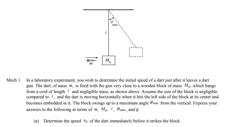

Why is (1/2)(mv0)^2 = 1/2(M+m0)gh not a valid equation for conservation of energy?
Isn't the energy from when the dart is shot the same as when the two masses move at speed v?

Your question is whether the collision between the dart and block is elastic or not?

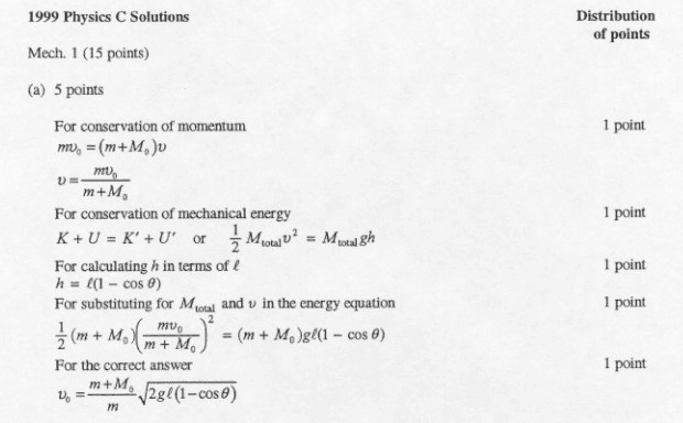

To answer the first question,
j04015 said:
Why is (1/2)mv0 = 1/2(M+m0)gh not a valid equation for conservation of energy?
Because ##\frac{1}{2}mv_0## has dimensions of momentum and not energy.
If the collision wasn't elastic the entire problem doesn't make sense.
That statement is false!
... the collision is manifestly and totally inelastic!
I see the issue now. Momentum is conserved but not energy. Thanks!
Likes PeroK
You can see that if you consider what's going on in the center of mass frame. Before the collision, both dart and block move with opposite momenta. Total momentum is zero and the kinetic energy is non-zero. After the collision, the dart and the block are at rest. Total momentum is zero (conserved) and total kinetic energy is also zero (not conserved).
Likes PeroK
The conservation of energy equations will not be compatible with conservation of energy in any frame if you assume that the dart sticks. However, I agree that considering the com frame makes it very explicit.
