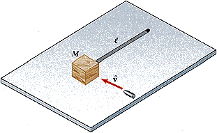

4. Homework Statement
A wooden block of mass M resting on a frictionless, horizontal surface is attached to a rigid rod of length and of negligible mass. The rod is pivoted at the other end. A bullet of mass m traveling parallel to the horizontal surface and perpendicular to the rod with speed v hits the block and becomes embedded in it.
(a) What is the angular momentum of the bullet- block system? (For the following answers, use M for the mass M, m for the mass m, and L for the length .)
(b) What fraction of the original kinetic energy is converted into internal energy in the collision?
4. Relevant equations
? If someone could just point me in the right direction4. The attempt at a solution
Start with the conservation of momentum of the collision between the bullet and the block. You need to figure out an expression for the velocity after the collision. Then consider the angular momentum of the block + bullet about the pivot point.

4.Using conservation of momentum find the velocity of the combined system of block and bullet. Then find the angular momenum. You can find the KE of bullet and bullet-block system.
