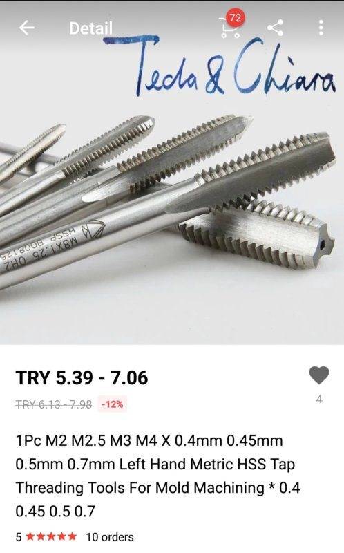

Hello friends.
First, I apologize for my bad English. I need your experience. I want to produce a piece, but I have a problem with tapping. The material is 303 stainless steel. I need a M2 tapping to this part. Approximately 200-300 pieces of M2 tapping will be made. For 303 stainless steel which tap do you recommend? How many mm drill and speed / feed do you recommend?

Are your taps wearing out earlier than expected? I do not see the issue with using a standard tap for this application.
I haven't tried it yet. So you're saying cheap HSS taps would be enough? Example this?
I don't use cheap taps. Why would you? Especially if you are planning on tapping many holes...
Is there a tap you can recommend?

I don't spam Sorry for upload pics. I am from Turkey and there is all local supply say don't have M2 tap. If you can give me brand or tap link I would be happy. Thank you.

What @Ranger Mike said, plus make the tap drill slightly larger. Most tap drills are sized to make a hole that results in (I think) 75% thread depth. I did some tests once with larger tap drills to get 50% thread depth and found no decrease in strength. Those tests were to help out the machine shop with a similar problem - tapping small deep holes in hard to tap material.
When threading stainless steel you should use “Cobalt High Speed Steel” drills and taps. CoHSS.
It comes in two common grades, M35 and M42.
https://en.wikipedia.org/wiki/High-speed_steel#Cobalt_High_Speed_Steels_(HSS)
CoHSS tools are expensive, but it is often the only way to cut such a small thread. You may be able to buy a spiral tap in CoHSS.
Avoid spiral thread-flow taps that do not cut, they deform malleable materials.
Google 'cobalt M2x0.4 spiral tap' or search ebay
