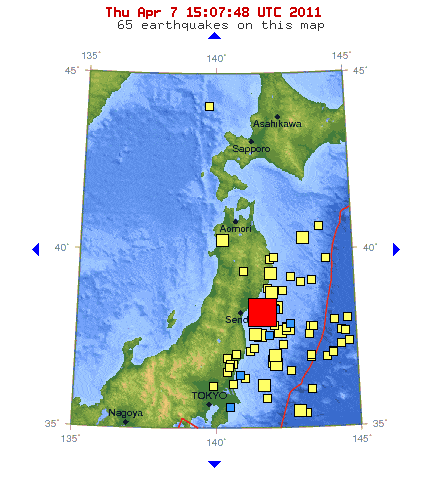

The earthquake swarm continues. Notice the more recent quakes occurring nearer to Tokyo and along the western coast and just west of Tokyo. There have been several 6+ mag quakes.
Can they expect another big one - 7 or 8+ soon?
Japan is starting to look like Yellowstone on crack.
