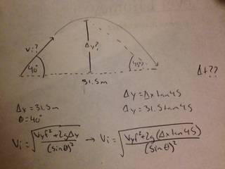

1. Homework Statement
A quarterback throws a football to a stationary receiver 31.5m away from him. If the football is thrown at an initial angle of 40° to the ground, at what initial speed must the quarterback throw the ball for it to reach the receiver? What's the balls highest point during flight?
2. Homework Equations
3. The Attempt at a Solution
I know this is only one small attempt at rearranging the formula, but trust me if you checked my trash you'd find crumpled up pieces of paper with many more attempts.
I always go through the same procedure;
1. I make my goal to find the initial velocity.
2. To find initial velocity, I need time.
3. To find time, I need /\y.
4. To find /\y, I need the initial velocity.
Please help.

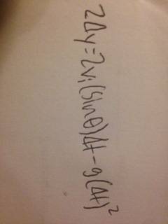

The motion has two dimensions: vertical and horizontal. Write the equations of motion w.r.t. time for both motions. The time that the football takes to reach its destination must be the same for both horizontal and vertical motions...
I'm sorry, but could you please explain more in depth? I know there's two dimensions but set what two motions with which equations?
The horizontal motion and the vertical motion. What are the equations for each?
Oh, the /\y and /\x equations? I thought you referred to the x and y components of the velocity..
Well, after trying to set them equal to each other — it gets to a point where the /\t can't be really set equal to the rest of the /\y equation and you have a quadratic of a sort:
The x and y components of the trajectory are independent equations in terms of time. Write them separately to begin with. (And it would be better if you would type them in rather than attaching image. Use icons in the editing window's top bar to make subscripts or superscripts: x2, x2. Other symbols and special characters can be found using the Sigma icon).
You should then have a pair of equations that describe the motion with respect to time. The only unknowns will be the initial velocity and time. Two equations in two unknowns.
