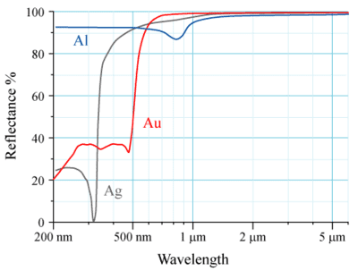

It will absorb a little bit of all the wavelengths. Mirrors can be made from many different materials to enhance their reflectivity of certain parts of the EM spectrum. For example, mirrors designed to reflect near-infrared light are typically made of gold because it reflects a larger portion of near IR light than most other kinds of mirrors. Aluminum is typically used to make visible light mirrors since it reflects a significant portion of visible light that falls on it, but will reflect less of other types of EM radiation such as UV or IR (it's also much cheaper than most alternative materials).
See the graph below, which comes from here: http://en.wikipedia.org/wiki/Reflectivity
As you can see, the amount of light reflected (measured by the Y-axis) changes depending on the wavelength and the type of mirror. Note that visible light has a wavelength between 400 nm to 700 nm. In this range the aluminum (Al) mirror reflects more light than the other two. Gold (Au) and silver (Ag) reflect more light in the near-IR range which is the right half of the graph.
Aluminium also reflects different wavelengths more evenly, so the reflections appear in the same colors as the original.
As seen from the side, mirrors often look greenish, revealing that they are not perfect mirrors but absorb different wavelengths a bit differently.
