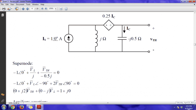

Here is the circuit. I have to solve for V Thevenin
I am having trouble figuring out what I am doing wrong here. I need to solve for Vth and I do, but it does not match with what my TA posted as the solution. [/B]
The equations I set up are the same as the above. VL is the node voltage on the jΩ inductor and Vth is the voltage on the right.
1. -1∠0° + (VL)/j + (Vth)/(-.5j) = 0
2. Vth - VL = .25Ic
3. Ic = Vth/(-.5j)Substitute 3 into equation 2.
4. Vth - VL = .5iVth
Now solve the system of equations for 1. and 5.
5. Vth(1-.5i) -Vth = 0
Vth = -0.4-0.8i
VL = -0.8-0.6i
Am I doing this correctly? The solutions my TA posted does not get this answer for Vth. She got Vth = .4 -.8i.

Your TA has forgotten the "-" in front of ".4".
He used VL-Vth = .25Ic. That is wrong correct?
Swagbinger said:
2. Vth - VL = .25Ic
4. Vth - Vth = .5iVth
What happened to VL?
Sorry, a typo, the second Vth should be VL
According to arrow and signs, it's wrong.
