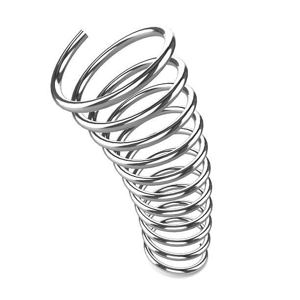

Hi everyone,
Any alternatives you know for metal spring? The idea is to find a replacement for a metal spring that has the same efficiency in bouncing an object that's hung by the spring. Any input of a kind would be valuable.
TIA
Welcome to PF.
What is the weight of the suspended mass ?

It varies between 5-10 kg
'Bungee' cords come to mind. They are probably not quite as 'efficient' as a metal spring if I understand what you mean by 'efficient.'
Fused quartz or glass is possible.
Maybe you can tell us why you need to avoid metal.
Springs can be made with plastic.

I'm working on a project where I need to hang an object which needs to move vertically as you pull it down. The longer it bounces the better it is. At this point, there is no clear reason to avoid metal - just looking for alternatives if any. I hope this is clear.
So this is for some sort of competition to see who can make the longest lasting linear oscillator using nothing but potential energy (sprung potential vs gravitational)?
You want to minimise your losses. Make the weights sit in an aerodynamic chamber, or better yet, a vacuum.
I don't know whether it would be more efficient to use a longer spring which is stiffer or a shorter one which is stretchier. on one hand, the longer stiff spring will flex less so generate less heat per volume, but the shorter one has less volume so the losses may balance out. My gut says the longer, stiffer spring would be more efficient, but gut feelings don't always work in Physics!
Make sure that any and all moving parts are well lubricated and not losing you momentum (EG don't use a bolt in a hole if you can use a bearing or a bush).
More info on what exactly you need will yield better answers. what does it have to do - what are the criteria. You don't have to reveal the purpose of the design, just the criteria you consider a success.
For minimal friction, you could suspend the weight on a pulley strap slung over a bicycle wheel, so you get full use of the bearings and can adjust the leverage applied by the spring by adjusting the distance between the wheel bearings and te spring affixing point, so that you can experiment with it to achieve your best results without needing to buy lots of springs!
