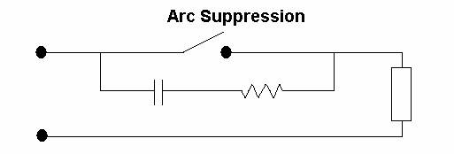

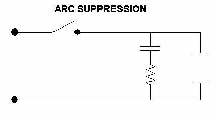

This Spark suppression .pdf file may be useful to others.
To prevent the contacts from being eroded a RC network is placed across the contacts. When the contacts open the applied voltage is placed across the capacitor and not the contacts. The capacitor is to charge up at a rate faster than the contacts open thus preventing an arc from forming across the contacts.

Years ago I used an oscilloscope to measure the voltage spike generated when a tiny 12V reed relay was switched off. It generated an extremely short duration 1.5kV spike on top of the 12V rail. Adding a tiny catching diode limited it to 0.7V ... but held the relay closed for much longer.
Check the voltage and current ratings for switches or relay contacts. You will see that the DC current rating is usually far smaller than the AC current rating. As has been said, AC extinguishes the arcs at the zero voltage crossing thus reducing damage to the contacts.
