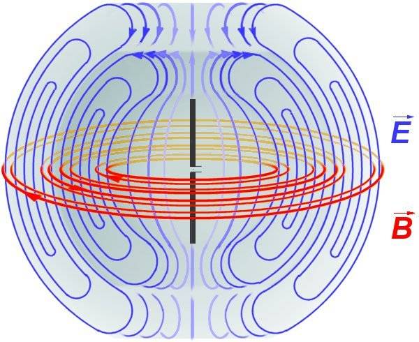

Hello, I've heard in many places that in the "near reactive field" of an antenna which is the region really really close to the antenna, the E and H fields are not perpendicular. But I just can't imagine how that is possible since In Maxwell's 3'rd and 4'th equations it is explicit that the curl of A is proportional d B / dt therefor they are in space orthogonal where A and B can be E and H.

The wikipedia article has some nice pictures... https://en.wikipedia.org/wiki/Near_and_far_field :smile:
Yeah I've read this before posting, but it doesn't really give a good explanation on what I'm asking. It only says something vaguely about my question. And there are no images on how the EM field looks like in the reactive region.
ohhh ?
from that wiki article
Near-field: This dipole pattern shows a magnetic field
in red. The potential energy momentarily stored in this magnetic field is indicative of the reactive near-field.if this isn't answering your Q directly, then try rephrasing your question :smile:
Dave
Likes CalcNerd
Hello Dave, as you can see the E and B fields in this image are orthogonal. Therefor it is a bad image since it clearly states that they are not orthogonal. Anyhow I came up with an explanation myself trying to figure it out. In the near field the electromagnetic field is not formed, therefor it is NOT an electromagnetic field yet, just electrostatic and magnetostatic and when they start to variate later on they form perpendicular E and H waves. I think that this is the only way to explain it. Unless it's some weird ass quantum physics effect of which I am not aware of.
