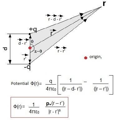

So, I'm solving a dipole thing and I have these vectors:
|r + d - r'| = (r² + d² - r'²)(1/2)
I want to expand this but I have no idea how! I know I may have an infinite power series, but I may expand at the square terms tops...
Before I needed to do the same with something like (a + b)(1/2) and I got it, I found how to do it. But in this case I can't find a conection...
Can anyone please explain to me how to? Or at least indicate somewhere where I can find it? Because I looked over and couldn't find...
Thanks...

What vectors? How are you managing to equate the lefthand side with the righthand side?
Sorry, I know I have not been very clear, but I'm trying to understand (and failing) that's why...
Here what I have (in the figure):
I need to expand the first term, conserve only the linear term in "d". I need to get the last equation...but I have no idea about what I'm doing :(
I need to expand the first term, conserve only the linear term in "d". I need to get the last equation...but I have no idea about what I'm doing :(View attachment 97857
Much better: write ##\vec{p} = \frac{1}{2} \vec{d}## so you have
[tex] \phi(\vec{r}) = \frac{1}{4 \pi \epsilon_0} \left[ \frac{1}{|\vec{r} - \vec{p}|} - \frac{1}{|\vec{r} + \vec{p}|} \right] [/tex]
Now
[tex] \frac{1}{|\vec{r} - \vec{p}|}=\frac{1}{r} (1-x_1)^{-1/2}, \;\; x_1 = \frac{2 \vec{r}\cdot \vec{p}}{r^2} - \frac{p^2}{r^2} [/tex]
with as similar expression for ##1/|\vec{r} + \vec{p}|##. Now use the binomial expansion for ##(1-x_1)^{-1/2}## in powers of ##x_1##, exactly as I had suggested in post #2.
In your case, stopping at the first power (##x_1^1##) will be good enough.
You have a sign error in your diagram, but I think your expression for the potential is okay for the way I think you're defining ##\vec{d}##. Still, you probably should start over and go with Ray's suggestion since ##\theta## is defined in terms of ##\vec{r}## and the dipole axis.
Remember that ##\lvert \vec{x} \rvert## is defined as ##\sqrt{\vec{x}\cdot\vec{x}}##. Use that fact and then factor the ##r^2## out of the square root to get the expression Ray wrote above on the righthand side of the equation.
