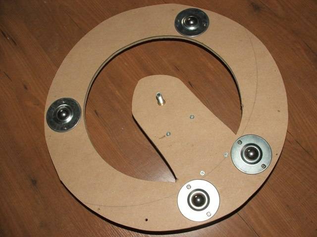

I need a contraption that can keep a ball spinning, smoothly, at a slow speed. If it has a variable speed control, that would be better, but minimally it would need to spin a soccer ball and take around 30 seconds to make a full rotation. The look of the device doesn't matter, just that it mechanically works.
Can anyone help lead me in the right direction on how I would go about building something like this?

What is the axis of rotation? Is the axis horizontal, or vertical?
Thanks! It would be vertical rotation, although if it doesn't complicate things much, having horizontal and vertical controls would be better. But vertical only would work for my needs.

What do you mean by "vertical rotation"? Does that mean the axis of rotation is horizontal, so it would be rolling in a motion like it was rolling on the floor?
Correct, spinning along the X axis (horizontal axis) as though it were rolling on the floor.
Got it. So make a hoop about 1/2 the diameter of the ball, and put 3 captured ball bearing assemblies equally spaced around the circumference of the hoop. That creates a cradle that the ball can sit in and spin in any direction.
Then use a geared-down electric motor with a roller under the ball to make it roll. The roller/motor height should be adjustable over a small range so you can just start to unweight the soccer ball from the ball bearing supports when making contact with the bottom of the ball. You should be able to find an adjustable geared-down motor so you can control the speed over some range.

I like to use Google Images to help speed up my searches for parts. I did such a search on:
small electric motor with reduction gear drive
and got lots of good hits. Maybe give that a try to see if you can find what you want (hopefully inexpensively via mail order). You can use a similar search to look for captured ball bearing assemblies.
Interesting. I just did the Google Images search on captured ball bearing, and again many good hits. This image in particular is funny because it's similar to what you will be building (it's for a different purpose):
http://www.lobousland.com/Dalek/Pages/dalek2_head_neck.htm

BTW, another option would be to change out one of the ball bearings for a roller. I'd make the roller roll down, I think, to help keep the ball held down in the ring. That's probably simpler than using 3 bearings and trying to tune the bottom roller to the right height.
