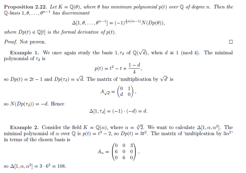

Question:
The needed proposition and two examples:
This is as far as I have got:
I need to reduce this (I think) so I can represent is as a matrix! Any idea on how to do this?
Thanks
