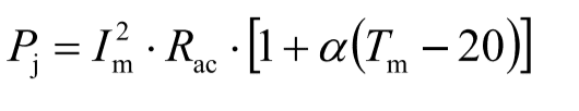

From the linked paper:
245259

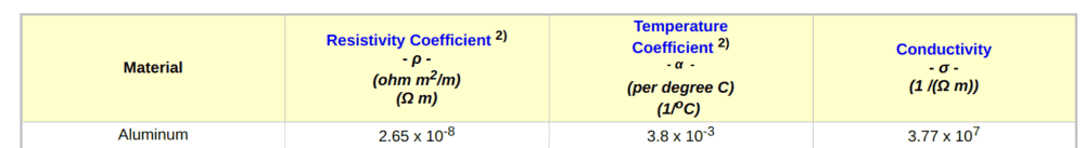

Alpha is the change in resistivity as a function of temperature. If the conductors are aluminum, here are the numbers from https://www.engineeringtoolbox.com/resistivity-conductivity-d_418.html
245258

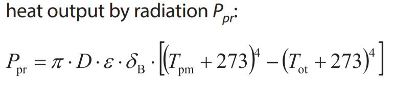

But I do not know the numbers for ##\epsilon## and ##\delta_B## in the following. Perhaps other PF members can help with that.
245261
