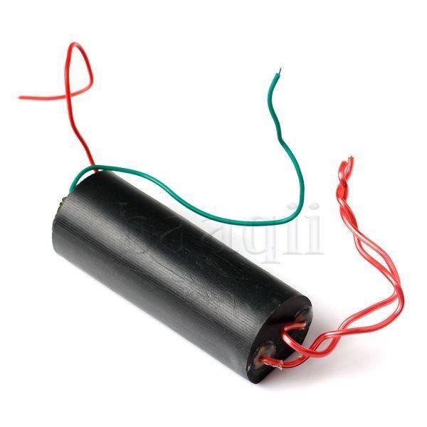

Any one know circuit inside DC boost step up pulse generator?
I have this one buy from ebay 400Kv type,i want to know how this work by circuit inside..
I had googling and not found result..
Please help me..

400kV? Is that a typo? What is the application?
I'd expect it to at least have a current limiting resistor and a capacitor, like a car ignition. But the nature of the arc makes me think there is more.

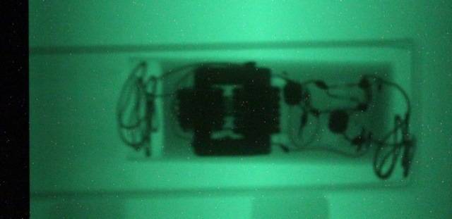

Right..
More like pulse with modulator..
And i have x-ray scaning
But dificult to identify the component inside

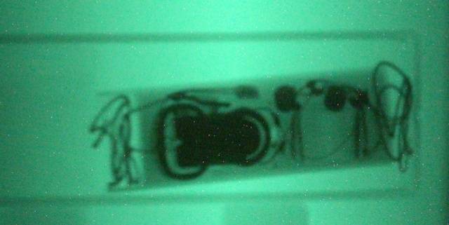

The large dark silhouette resembles the EHT transformer from a TV: a square ferrite core with the bulges being two separated windings. The other components would form the oscillator and driver to pulse the primary winding of that transformer.
