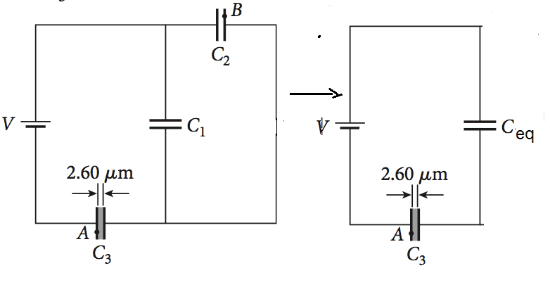

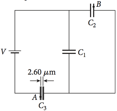

A potential difference of V = 38.0 V is applied across a circuit with capacitances C1 = 4F, C2 = 5F, and C3= 2F, as shown in the figure.
  1. What is the magnitude and sign of q3l, the charge on the left plate of C3 (marked by point A)?
  2. What is the electric potential difference, V3, across C3?
  3. What is the magnitude and sign of the charge q2r, on the right plate of C2 (marked by point B)?
Q = CV

3. Solution:
1. C1+C2=C12 = 9F
Cequivalent = (C12 * C3)/C12 + C3) = ~1.6F
q3l = Ceq * ∆V = 60.8V
2.
V3 = Q3/C3 = 60.8V = 30.4 V
3.
q2r = C2/(C1 +C2 ) * Q3 = 34.05 CAlready have the solutions, just need explanations.
C1 and C2 are in parallel, therefore should have the same Voltage (potential difference).
Third one is the one I'm having trouble with.
q2r = C2/(C1 +C2 ) * Q3 = 34.05 V
Unit of charge is coulomb, not volt.
This will give you the total charge on the equivalent capacitance. Since parallel combination of C2C1 is in series with C3, charge on equivalent capacitance will also be equal to that on C3.
This will give you the total charge on the equivalent capacitance, not the charge on C3 alone.
it does give you the charge on the left plate of the Capacitor3 (meaning, it is the correct answer).
Right. I just edited my post. I myself had drawn the diagram wrong, showing C2 in place of C3. Apologies..

vizakenjack said:
1. The voltage across C1 and C2 is the same, correct? But their sum doesn't equal 38V, nor does it mean that voltage across C1 is 38V, correct?
But whatever the voltage across C1 is, it's of the same magnitude in C2, despite the fact that capacitors have different capacitance?
Yes. From basic network theory, elements in parallel share equal voltage. As you know
V=Q/C, Q1/C1=Q2/C2. The charges on the capacitors will be different if the capacitances are different.
vizakenjack said:
2. Why is the equivalent capacitance and the given voltage is used to calculate the charge on C3 instead of Q3 = C3 * V3?
I know the formula Q3 = C3 * V3 is valid, but how come the equivalent capacitance * given voltage also yields V3?
As I said in my edited post #2, parallel combination of C1C2 is in series with C3. So, charge on C3 will be same as that on the equivalent capacitance( charge on series capacitors is same).

The voltages across series elements add up. So the voltage across C3 + the voltage across Ceq is equal to 38 V.
You got the charge on C3 by multiplying 38 V by the total capacitance. What is the voltage V3 across C3? So what is the voltage across Ceq, the parallel combination of C1 and C2?
Likes vizakenjack
Why does it give me the charge Q3?
Why Q3 = 38V * Ceq? It should give you the overall charge, if you combine all capacitors. But you only need the charge Q3...
Charge on series capacitors is same as that on the equivalent capacitance.
So, 38V*Ceq=C3*V3
So, 38V*Ceq=C3*V3
That'd be true if you had the charge Q12 (combined charge of C1+C2), then the charge Q3 = Q12
That's not the case here, when you do 38V * C123 (eq) you're finding the charge Q123, not Q12...
Q3=Q12=Qequivalent capacitance of C3 in series with C12
Suppose C1 and C2 are in series. Their equivalent capacitance=Ceq=C1C2/C1+C2
Now, charge on C1=charge on C2=charge on Ceq.
Likes vizakenjack
"equivalent capacitance of C3" doesn't even make sense, what is it??
Ceq = C123.
Q1=Q2
but it can't also be = Qeq, maybe they add up to Qeq, but Q1 < Qeq for sure. How can one capacitor hold the same amount of charge than the two capacitors one of which is the same?
I meant equivalent capacitance of "C3 in series with parallel equivalent of C1C2"..forgot to add double quotes..
Nope, not for series capacitors!:wink:Think about it. Suppose you have two capacitors of 5F in series and you apply 10V across their series combination. Voltage across each capacitor will be 5V, so charge on each capacitor=Q=CV=25C. Their series equivalent capacitance will be 5/2=2.5V and voltage across equivalent capacitance will be 10V. So charge on the equivalent capacitance will be Q=Ceq*V=2.5*10=25C, same as that on the individual capacitors.
When capacitors are in series, charge on individual capacitor is equal to the charge on their equivalent capacitance. Ceq for series capacitors is less than the individual capacitances but voltage across the equivalent capacitance is greater such that,
CindividualVindividual=CequivalentVequivalent=Qindividual=Qequivalent.
Here, Cequivalent<Cindividual but Vequivalent>Vindividual such that their product(i.e. charge) remains the same.
Hope this makes sense now...
Likes vizakenjack
If you remember how series capacitors are charged, you'll see that the charging current and charging time are same for each capacitor. This means the charges on each capacitor MUST be equal.
