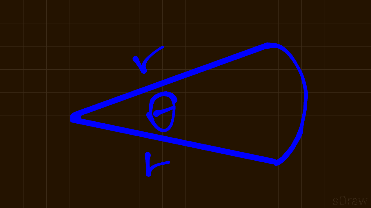

The given picture shows a circular sector with radius r cm and central angle θ (radian measure). The perimeter of the sector is 12 cm.
1. Express the area A of the sector as a function of θ. Is this a quadratic function?
2. Express the area A of the sector as a function of r. Is this a quadratic function?
3. For which value of r is the area A a maximum? What is the corressponding value of θ in this case?

We know the perimeter $P$ is:
\(\displaystyle P=2r+r\theta=(2+\theta)r\tag{1}\)
The area is:
\(\displaystyle A=\frac{1}{2}r^2\theta\tag{2}\)
(1) gives is a way to relate $r$ and $\theta$. So:
1.) solve (1) for $r$, and substitute for $r$ into (2) to get $A(\theta)$. Now, you will also have the parameter $P$ present, but it has been given, so you can just plug that in once you get the formula. What do you get?
2.) solve (1) for $\theta$, and substitute for $\theta$ into (2) to get $A(r)$. Now, as before, you will also have the parameter $P$ present, but it has been given, so you can just plug that in once you get the formula. What do you get?
