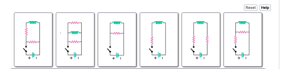

Rank the circuits based on the current through the battery immediately after the switch is closed.
Rank from largest to smallest. To rank items as equivalent, overlap them.
none given but i=(E/R(1-e^-(R/L)t))
is the equation I found in the book for the current through an LR-circuit. The problem is I can't find anything in the text I have that deals with resistors in series vs parallel, if a coil acts as a short, etc. So can I ask you...
1) is this equation valid for both resistors in parallel and series?
2) If I have a set up like the second and third from the left will the current go through the coil like a short circuit or does the coil have a resistance?
3) in a situation like the second from the right, I can use this equation with the total resistance of the branch and the inductance of the coil? Or does the order matter and if so why?
Are there any concepts I'm missing that I need to analyze an RC circuit?
Thank you for your help.

Firstly, if the battery is treated as ideal, meaning it has zero internal resistance, then 2 out of the 6 circuits will lead to nonsensical results. This can be avoided by treating the battery as non-ideal, having a small, non-zero internal resistance.
I would not worry about the equation for this exercise. The key word is "immediately," in "immediately after the switch is closed."
One key factor in solving this problem is to answer these two questions:
(i) Is it possible to instantaneously change the voltage across the terminals of an inductor?
(ii) Is it possible to instantaneously change the current through an inductor?

I know that the current in the circuit isn't going to change instantaneously as the inductor is going to resist any change to magnetic flux due to self induction...? If the current can't change instantaneously then voltage can't change instantaneously right?
so an inductor resists rapid changes to current?
so with the series circuits the current at t=0 would be zero (and then increase at something like a time constant I saw with capactiors)?
if the current through the inductor won't change, won't the current go through the resistors in the parallel circuits (path of least resistance?)?
Correct. The current through an inductor cannot change instantaneously.
While the current through an inductor cannot change instantaneously, there is no such restriction to the voltage across an inductor.
The voltage across an ideal inductor will be whatever it takes to keep the current from changing instantaneously [Edit: "Discontinously" might be a better word here].
Correct. Inductors resist rapid changes to current.
Correct again! :smile: However (and this is important), that assumes that the initial current flowing through the inductor is 0. For this problem, I think you are supposed to assume that the initial current is 0.
Yes, it is similar in that respect. There are some differences though, but yes, the exponential time constant idea is similar.
Yes, both current and voltage can change instantaneously across the terminals of a resistor. Now, knowing what you know about the inductors, you can use the current involving the resistors to rank the circuits.

If you connect an ideal inductor across the terminals of an ideal battery, the current will blow up to infinity immediately because there is 0 series resistance.
Putting it another way, connecting an ideal inductor across the terminals of an ideal battery -- and leaving it at that -- is nonsense. It's like asking, "what happens when an unstoppable force encounters an unmovable object," or some-such nonsense.
No, it won't. The inductance will limit the current.
Likes collinsmark and Delta2
Solving the differential equation ##E=L\frac{dI}{dt}## that corresponds to the circuit of an ideal inductor attached to an ideal emf source we get the solution ##I=\frac{E}{L}t+c##, I don't see how that goes up to infinity immediately...

Whew ! You really had me going there. I thought I was having a brain fart or something, but what it is, is that you are mistaken. When the switch is thrown, the inductor has INFINITE resistance to a sudden spike in voltage, so acts like an open circuit. Yes, it becomes a problem in the steady-state long run but not when the switch is thrown. That's undoubtedly part of WHY the question is being asked, to see if the student understands that fact, and I see from post #8 that you clearly DO understand that so I'm not clear why you would say what you did regarding the answer to the question.
Likes collinsmark
@phinds, @vela, and @Delta2 are correct. The current will not blow up to infinity [well, not immediately], even if all components are considered ideal. My mistake. Sorry. My bad.
