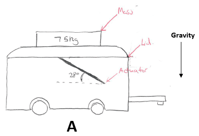

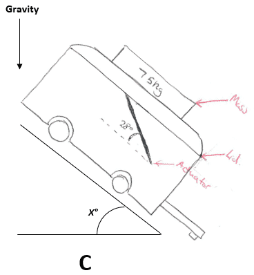

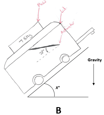

Hi guys, I've had another thought.
Assuming same actuator specifications, which of the three scenarios would draw more current from the actuators?
Based on my understanding of basic physics, I am inclined to say Scenario B, mainly because the vertical force component of the actuator relative to gravity has decreased, or even gone into the negative. Scenario C would draw the least amount.
As you can tell, these actuators will be used to lift a lid with mass on top. These lids are attached to trailers, and the trailer may be parked at an X incline.
Can you put some dimensions on one of the drawings?
