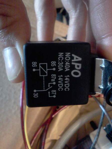

Greetings E.E. Gurus!
I'm a noobie in need of your guidance!
Here's the situation:
I have a 5V DC, 0.25 amp (1.25W ?) power source from an oil pressure switch wire on an old truck that is activated only when the engine is running.
My goal is to activate a 12V DC, 2.5 amp, 30/40W relay, which will be activated continuously while the engine is running.
I have yet to take a course in electronics, and will do so in the future... but right now I have this dilemma...
I've done a bunch of reading online but have not had any luck finding the info I need to build this simple circuit...

It sounds like you can use your 5V signal to power a 5V relay, and the output of the 5V relay can drive the 12V relay. What is the required coil current for the 12V relay? The 2.5A number is the allowed output current, I would think, and not the coil current.
Hmmmm... I'm not sure... How can I find out? I have the relay...
Does it have a manufacturer name and part number? You can use that to find the datasheet on the Internet usually...
Here's a pic. thanks for your help!
I'll do some research on that and post it ASAP... thanks!
Hmm. My googling is not showing APO as a relay brand so far...
Are there any other markings? Where did you get the relay?
I found a similar one on ebay. I messaged the seller to see if he has a data sheet...
http://cgi.ebay.com/ws/eBayISAPI.dll?ViewItem&item=370478844324
so according to the seller, there's no data sheet for the relay...
How can I test the relay to see what the minimum current to activate the coil would be? Would a variable resistor or something, help?
You can just put 12V across the coil and measure the current.

So I ran a bench test with a variable AC/DC power supply and found that the relay did not switch at 5.75V, 1.7A, but DID switch ON at 7.65V, 1.65A
Couldn't a simple transistor circuit be made to amplify 5V, 0.25A ?
I found a transistor circuit example here, but I can't follow it too well... It doesn't allow me to adjust the base current...
http://www.bcae1.com/transres.htmIf so, what exact components would I need?
I read somewhere I should start with a diode to prevent any current leaking back to my power source and then use a resistor in series with the base, and add resistors to the emitter and collector, but I don't know what sizes, etc.
Also, a diode should be attached across the relay coil to prevent any voltage spikes when it's turned off, but I don't know what size...
Yes, you should be able to use the 5V source to drive a transistor. Connect one side of the relay coil to +12 and the other coil terminal to the collector of the transistor. Put the emitter of the transistor to ground.
The sensor's 5V ouput would go to the base of the transistor through an appropriate resistor. Don't forget a flyback diode across the relay coil to protect the transistor.
Awesome! Thanks mdjensen22! Can you tell me which transistor and diode to use?
The transistor is dependent upon the current of the relay coil for energization. You need to measure this or find a datasheet for the relay. I assume something like a 2N3415 should work.
For the diode, I typically use a 1N4004, or a 1N4148 depending on the design.
Your base resistor will probably be something like a 1K or less (470 maybe?). This is calculated based on the collector current (relay coil current) and the current gain of the transistor that is selected (Hfe).
