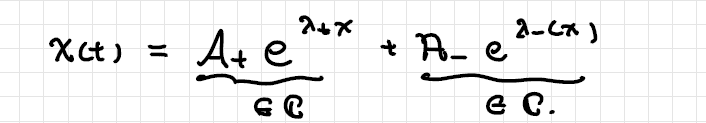

Deriving the differential equation for the underdamped case
In summary, the general formula for oscillation involves complex conjugates and the underdamping oscillation formula includes the use of λ, A+, A-, λ+, and λ-. After some operations, the final answer for x(t) is Ae^(-γx)2cos(θ+ωx), which is missing a factor of 2 in the solution given by the teacher.
Tony Hau
101
30
The formula for general oscillation is:
The formula for underdamping oscillation is:
where λ = -γ +- sqart(γ^2 - ω^2), whereas A+ and A- , as well as λ+ and λ-, are complex conjugates of each other.
After some operations, we get:
x(t) = Ae^(-γx)[e^i(θ+ωx) +e^-i(θ+ωx)], where A is the modulus of A+ and A-.
The notes of my teacher give the answer as
Obviously, the complex part of e^i(θ+ωx) and e^-i(θ+ωx) cancells each other. However, the real part of the two expressions is the same. So, why isn't the final answer of x(t) Ae^(-γx)2cos(θ+ωx)?

The solution given by my teacher indeed misses a factor of 2. My guess is correct.
