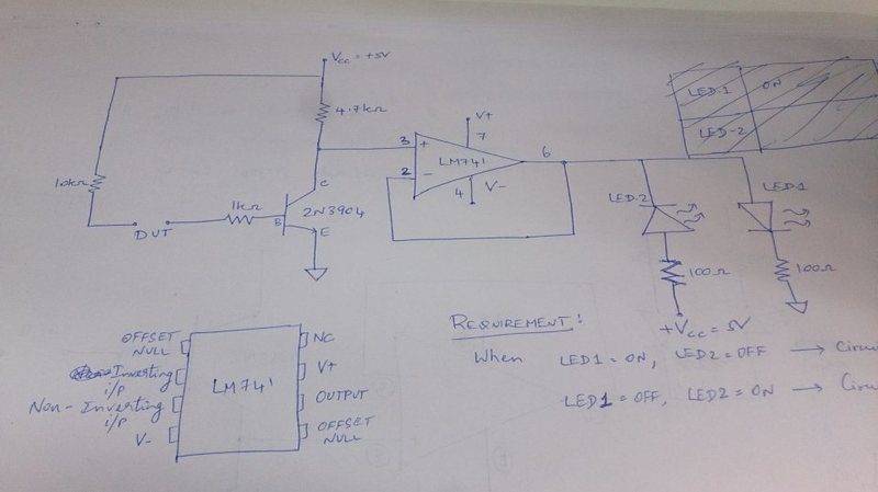

I would like to clarify few doubts on my mini-project as mentioned below:
I am designing a small kit using a transistor (2N3904) and an OP-AMP (LM741- Voltage follower) with few resistors connected to them. My power supply voltage value is 5V. Please refer to the below picture for your understanding. Am stuck in a situation where, I need the following logic as output but it is not the case.
  • When the circuit is OPEN, # The voltage at inverting input is half of the supply voltage (i.e., +Vcc / 2) # The voltage at non- inverting input is Zero # The output of the OP-AMP is either low or negative (i.e., LED 2 – status ON)
  • When the circuit is SHORT, # The voltage at inverting input is Zero # The voltage at non- inverting input is half of the supply voltage # The output of the OP-AMP is high (i.e., LED 1 – status ON)
I hereby attach the circuit diagram for your reference.
I believe the above circuit will provide you a clear idea about my query. Hoping for a favorable reply from you folks.

You need some resistance from the base to ground, maybe 10K, so leakage won't turn the transistor on.
Once you do that, C will be VCC when DUT open, and 0.3 when DUT shorted.
You have the opamp configured as a unity gain follower such that the output will always be at the same voltage as the + input.
The 741 is a poor choice for an LED driver.

Yes, if you are using +5V and Ground only. Why do you show a split power supply to the opamp?
And in general, simple opamps will not be able to drive LEDs directly -- You should perhaps use a logic gate after the opamp as a buffer to drive the LEDs.
Just some suggestions.
1. Find a 5V opamp with rail to rail drive capability.
2. You really don't need the input transistor. You can easily sense the open/short with the opamp directly.
3. Each Led should have a driver transistor. Opamps typically do not have adequate drive current to light an LED.
When the opamp is high, it can drive an NPN to conduct for 1 LED.
When the opamp is low it can turn on a PNP connected to Vcc to turn on the other LED.
You can also use small MOSFETs to do the same thing.
4. Or, instead of #3 You can use a CMOS driver like the 74LC244. I think there are 1 and 2 part packages like the 74HC2G34
5. You can easily do the whole thing with just the logic buffers (no op-amp)
6. Typically people use voltage comparators to drive analog threshold sensing to logic levels. (rather than an opamp)
I'll leave the details to you, but feel free to ask more questions.

Sorry I was busy with my exams these days. But for a trial, I completed a short-open circuit using LM741. Please post your comments if this has any corrections or not.
where, R1 = R2 = 10K ohms and R3 = R4 = 100 ohms.
Shall I replace the two LEDs in the circuit with a Bi-color LED? Need your advice.
1. need a pulldown on + input. Open is not equal to zero (because of input leakage).
2. 741 won't run on 5V. Needs something like +-5V.
3. 741 won't drive rail to rail.
4. Opamp output drive is generally not enough to drive LED's, and it certainly won't drive to the rail when driving a big load.
An LM7301 is a better 5V opamp, but it also won't drive much current (most opamps won't)
You need LED drivers.
